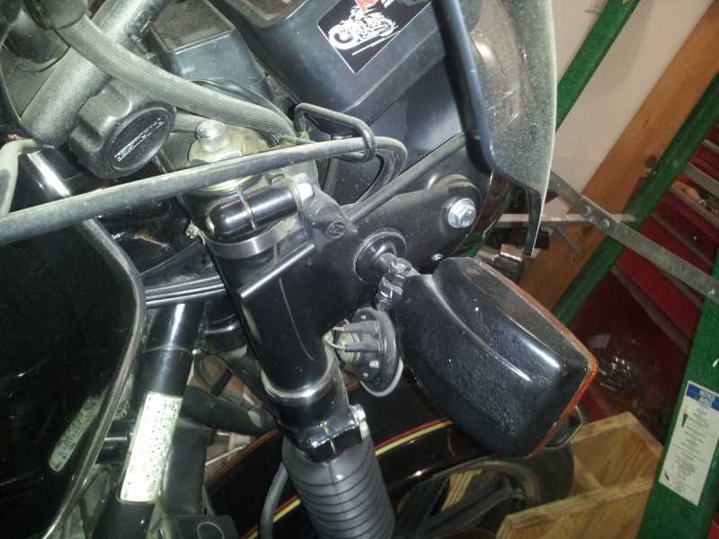

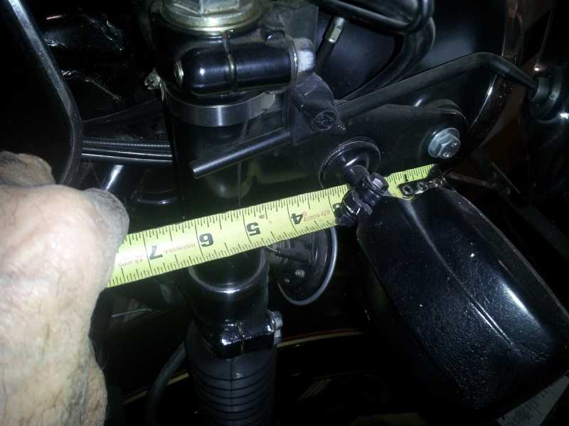

Hi Brian,
I found five inches from the center of the fork tubes to the center of the headlight pivots. The turn signals are right in the middle.
Here are a couple of pics.
Hope this helps.
Bill

No eBay APP ID and/or Cert ID defined in Kunena configurationThanks Bill. The ones I found on Ebay are 15 cm (5.9 inches) total length so they should be almost an exact fit. Looks like I would just have to drill holes for the turn signals.
