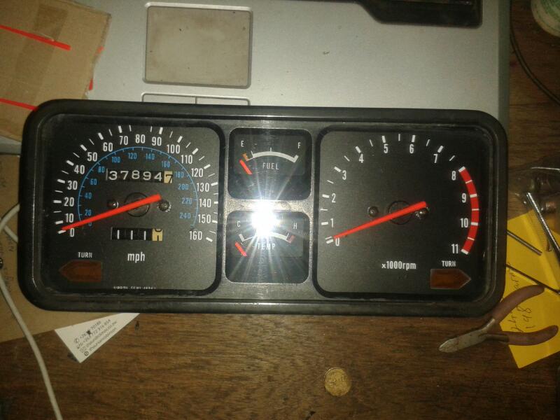

Almost there! Just carrying out final touches. The new needles from Lauri look great. Managed to get matching model paint for the temp and fuel needles:)

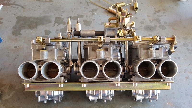

So we fired her up and pot 1 & 2 idle circuits on the carb blocked !!! Bugger!!! ....and I put a lot of effort trying to clean those! Have since ordered the carb Cleaning Tool from Scotch, but not sure I will have it in time before my venture with my son on both 13's. So I have rebuilt another set. Fingers crossed gents.

Craig wrote: Almost there! Just carrying out final touches. The new needles from Lauri look great. Managed to get matching model paint for the temp and fuel needles:)
I tried the Model Paint also on the temp and fuel needles, looked good to start with but after a year or so in the aussie sun they have faded again, the new speedo and tach needles are still a good colour.
