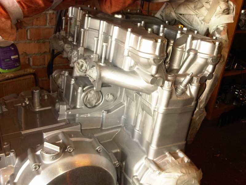

The REAL UK spec bike had no reed valves at all.
See my current engine below.........no reed valves.

Amazing what one can learn.
It's not the frame mounts for the fairing because all schematics show it.
www.kawasakiepc.com/SystemSearch_Frames....998&CFTOKEN=56912586
What a pain that reed valve is when taking the valve cover off- I never knew you other guys didn't have to fiddle with that.
