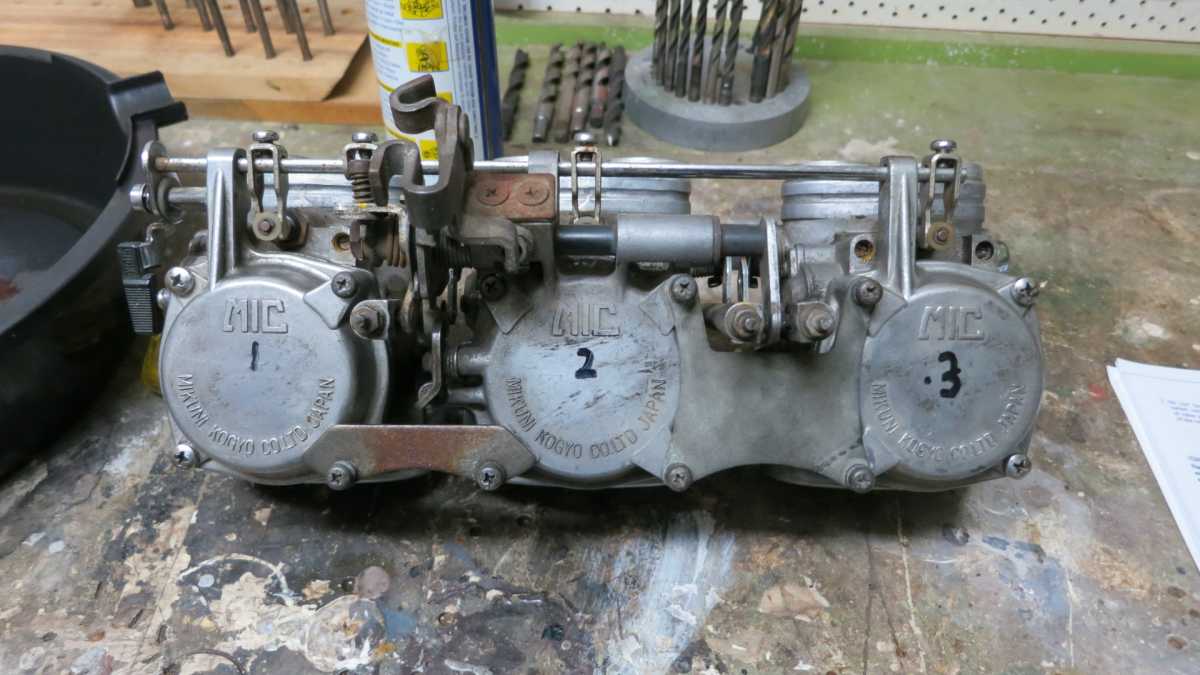

Carbies before clean

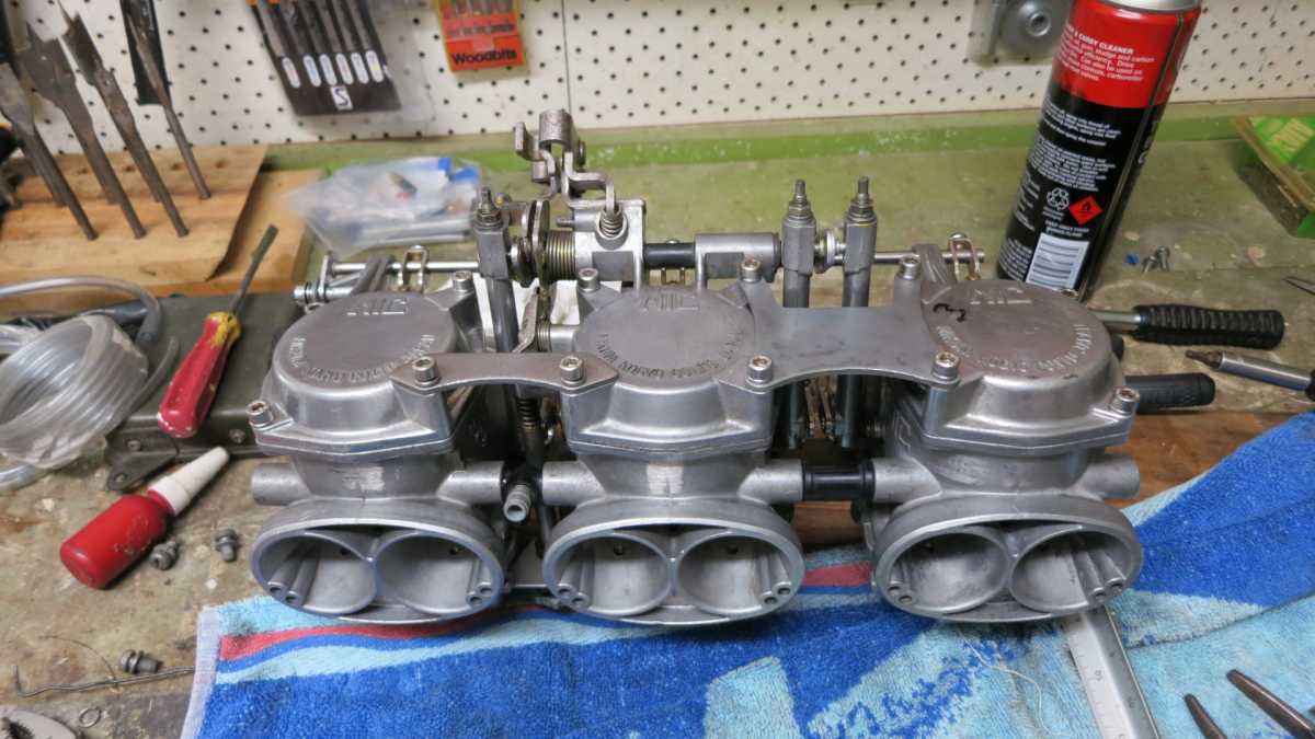

Carbies after clean
New carbie Kits were installed on all three with viton o-rings

The carbies are back on the bike although I still have some sorting out to do as she is kicking over but won't start. The problem with the starter solenoid getting hot is not an issue now and the motor turns easily.
