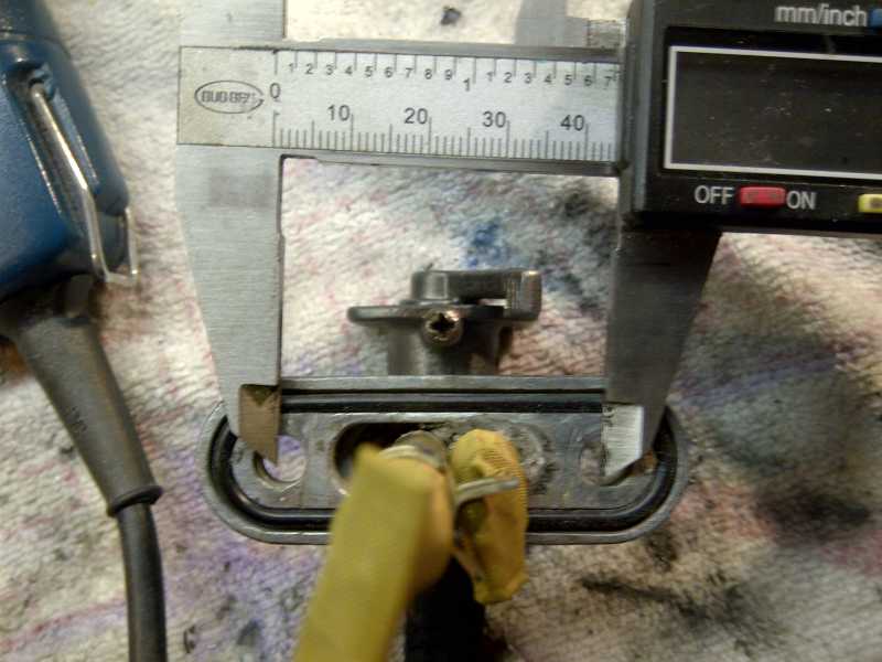

Mikez,
Brilliant !!
Thanks for that info. It looks like the GPZ900R is an identical petcock if the gaskets are anything to go by (same size & ref).
The problem has been the pitch between the 2 mounting holes (see photo below). There are many different sizes.
Our 1300 is 43mm pitch (centre to centre) holes.
Some suzuki & other bikes have what looks to be the same petcock but the pitch is smaller so not suitable.
Pete F
Brilliant !!
Pete F
