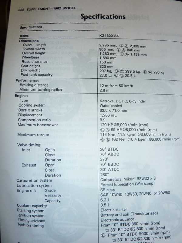

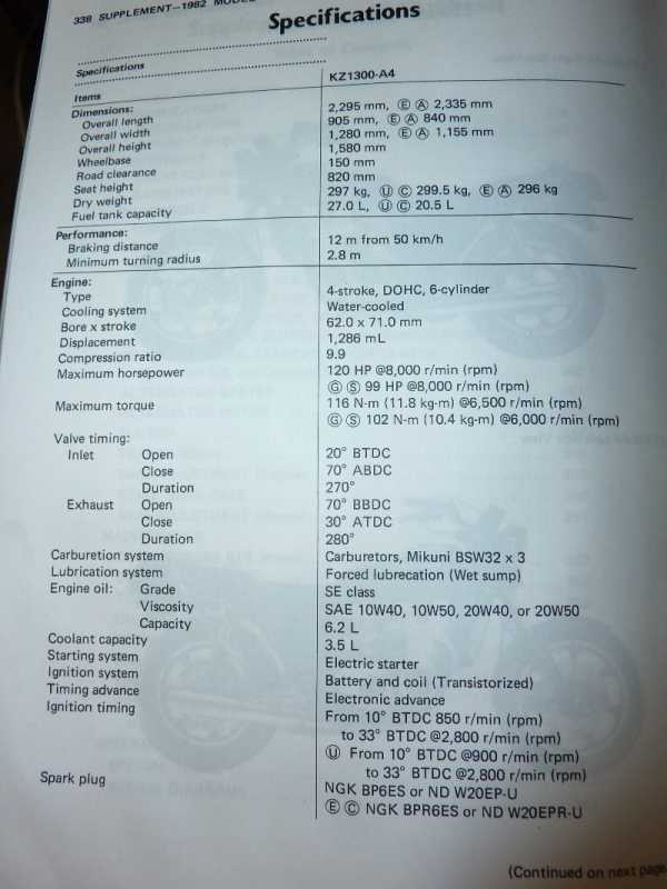

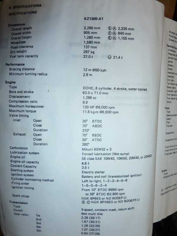

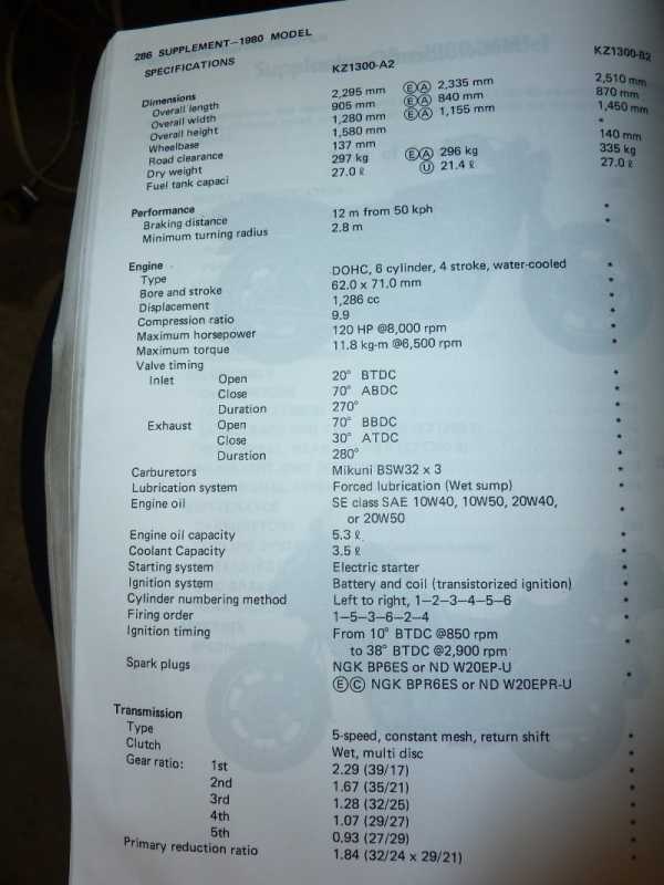

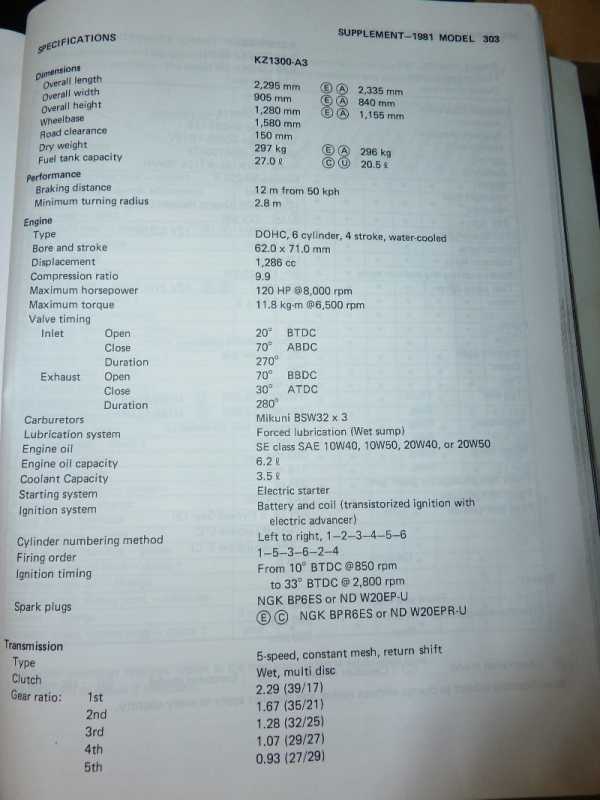

Checked one of my manuals. There does appear to be 3 different oil volumes for engines[/attachment]
listed.
If there is only two different oil pan volumes , and all clutch covers are the same size, then how is there 3 oil volumes.

No idea, but the 79 oil pan is way different than 82. 82 holds more oil, I think it's deeper, that oil pick up is also longer.
There might be no changes in overall engine design, but a deeper oil pan with different passages might accommodate some of the extra oil. Also, and again I am just blindly speculating so feel free to hang my by my balls while I'm not guilty of assumptions, hahahaha, maybe the oil filter compartment hold a bit extra oil as well?
This relates to my other thread I just started about cross reference. Basically, I'd like to put an engine together from scratch, from different all over the place parts. I'm trying what fits where, and what are the universal interchangeable parts, as well if it is possible at all using a generic 79 - 82 or whatever crank case.
