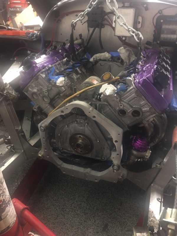

I don't cure them if I am in no hurry to use the parts. If it sits a week the paint will be rock hard. It can "temperature cure" on the motor. If I want to use the part in a few hours, I set it in front of a small heater and rotate it once or twice.
You really don't need to use engine paint. Regular paint works fine, but may burn right around the exhaust flanges. I use Dupli-Color Metalcast (looks like Anodized) on lots of engine parts without issue. Though I can't imagine ME using funky colors on a KZ.
For example, the valve covers is this shot are Dupli-Color, the waste gate is anodized.
