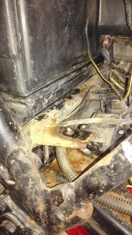

I have been busy with my 1300, and now I can start assembling or I can strip the frame completely for new coating. Battery acid caused the issues, so now I can either start assembly or strip further.... I have to replace the oil seal on the drive shaft as there's an oil leak on the motor. Is it a lot of work to remove the engine from the frame? Can it be done alone or which methods can I use to remove it?

your frame definitely needs attention. Having it powder coated would be really nice. failing that, an epoxy paint or 2K paint would be my second choice.
The Service manual is quite good at describing this task. If you don't have a copy of the manual, one is available on the Home page of this site.
I pulled the engine out of mine by myself. It's a bit of a handful but doable.

I pulled my engine by myself, also. Basically as the manual describes. Used a strap and small hand winch (come-along) clamped to a floor-joist. Was actually relatively easy.
If I recall correctly, the engine weighs in at 235 lbs.
