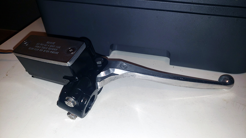

This is not the master cylinder which is still on the bike, but a spare one. I might use it or keep it for the future. The one on the bike works great so it should be just fine after checking it and servicing. Either way, this one will eventually be on a running bike.
I 'honed' the bore with metal polish, then oil, and a 2000 grid paper for wet application. Looks good! The seals looking good as well, so after some time in my ultrasonic cleaner, detailing, polishing and painting, this master cylinder is looking good and ready to brake!
Stainless Allen bolts might come later, but in the meantime I like the stock. I also really like the black body and shiny lid theme. The lid got chrome plated on my first bike, but on this it will be just polished aluminum.

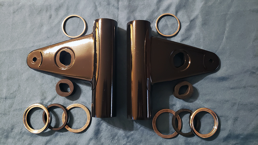

This is literally a gift from heavens. I got a bunch of parts for free a while ago from a member who did a full rebuild of his bike, and I truly cherish them! Please, don't be jealous
I gave these ears a fresh coat of paint and they look new. The rest is also in a great shape. I am going to replicate the rings at one point! All these parts are hard to come by. They will go on this bike but at one point I am going to make a switch with what I have on my first bike - it has a pair of aftermarket ears and I want it completely stock.

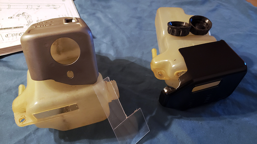

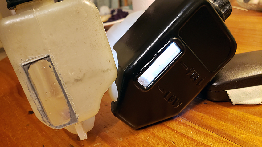

Working on two coolant tanks. Right - cover painted black and like new. Left - still just sand blasted and I think I will treat it for chrome plating. These cover are easy to switch, will be good to have one each for different looks.
The brittle areas are being cut out and covered with fresh clear polycarbonate, bonded with JB Weld. It works great! I have done that on my first bike and no problems. As expected. Having a real clear plastic in the view window is great as well for change - you can truly see the level and color of the coolant.
So yes, it's simple. I will have these two pairs ready in no time and minimal effort. Another piece on the shelf of parts to mount on the bike, when the frame is ready.

The fix is done. THe right one ready for a bike, but I will chrome plate the other cover and use it instead of black.

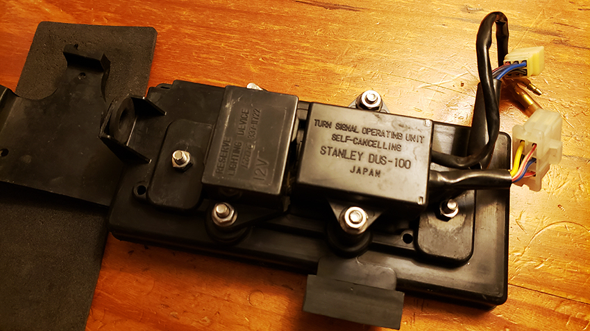

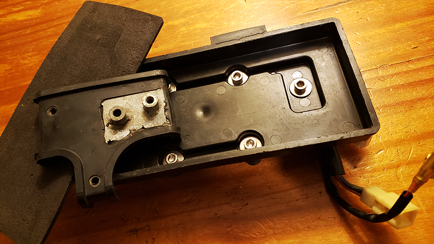

The battery tray with the electronics has been ready for months now. Time to make it official. All bolts replaced with stainless. Ready to go on the bike when the frame is ready.
And I also already have a battery. Fully charged!
