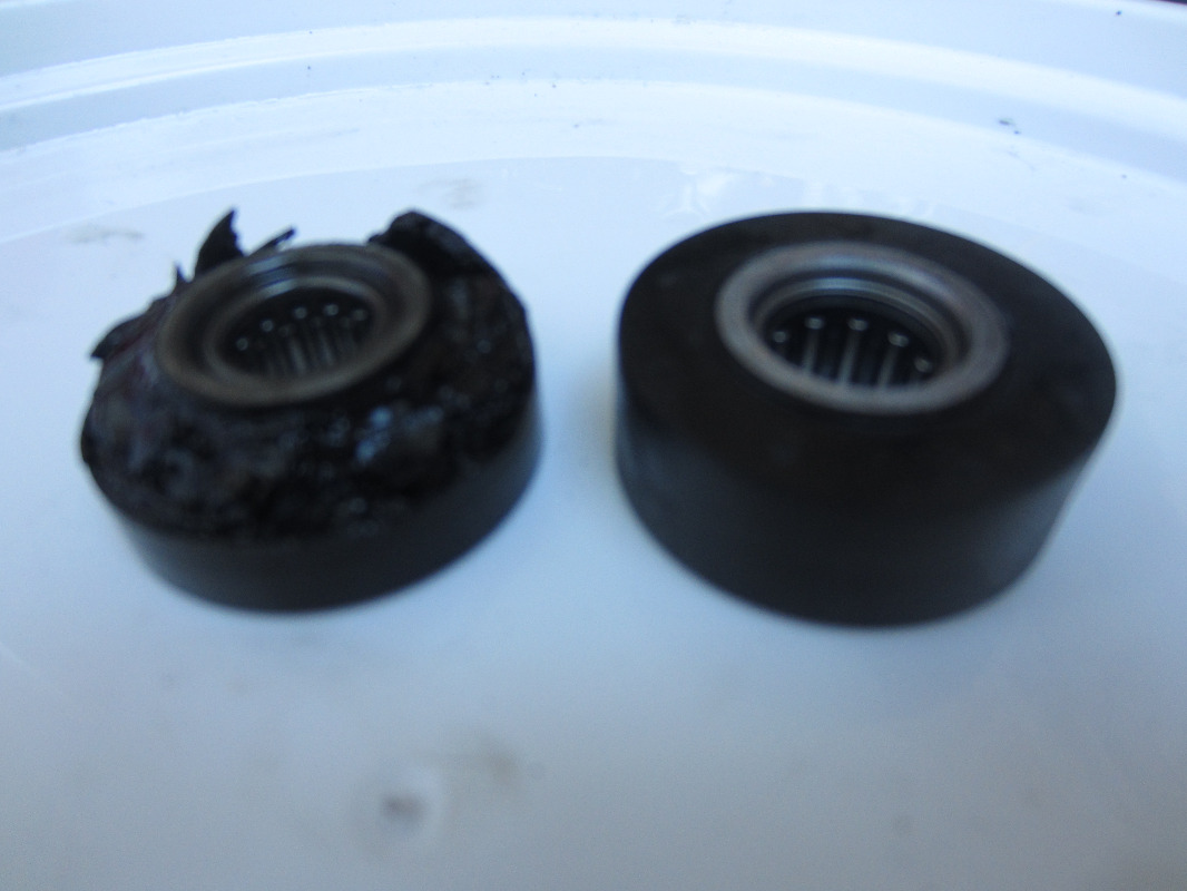

In the meanwhile, there were inconsistencies with the manual cam chain adjustment and I also noticed a barely visible green stain in the shape of a couple of drops on the outside of cylinder #1.

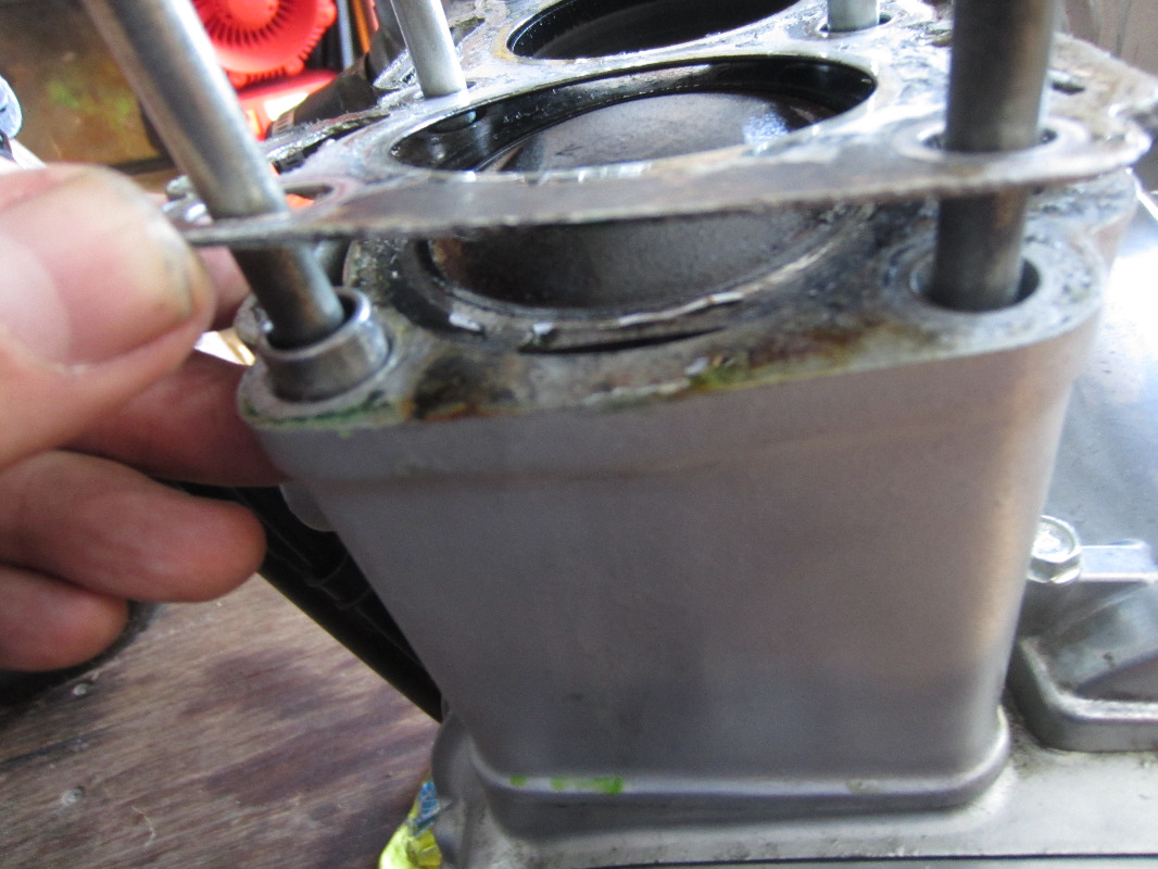

So… the head had to come off and once removed, I was able to confirm that the head gasket was leaking and that the lower rubber cam chain idler wheel was partially shredded (another possible candidate for the intermittent, abnormal engine noise, I thought).
It looked to me like the PO had previously fitted an accessory brand head gasket (without the sealant rings) and it didn’t look like he used sealant around the water jacket ports or (anywhere else).
I gave the head the old “fill the ports to the brim with petrol” leak test – there was not the slightest leakage past the valves which was a surprise, I decided not to remove / disturb them.
I did not remove the block either, the cylinders are on standard bore and looked ok.
I had checked the cylinder compression (hot) earlier and the results were all within the manual service limit spec.
I cleaned up the top of the pistons and the combustion area in the head with some kero and a rag and was surprised how easily they cleaned up – I’m guessing that the only miles this head has done since being refurbed are the ones I have put on it whilst I have been out riding the back streets (initially struggling with carburation and other issue’s).
I installed the head using a new OEM gasket, I was unsure, but in the end, I used a little additional sealant on both sides of the gasket.

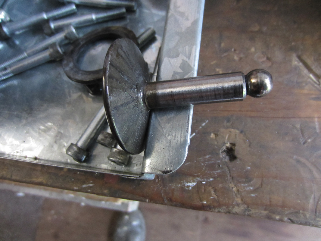

By chance I happened to discover that the sound was coming from the tacho unit, when I disconnected the cable, the sound abruptly stopped.
Upon disassembly and inspection of the Tacho, the spinning discs that hold the magnet was partially seized and hard to turn by hand.
I was able to free this up using some fine lubricant and that seems to be the end of it…

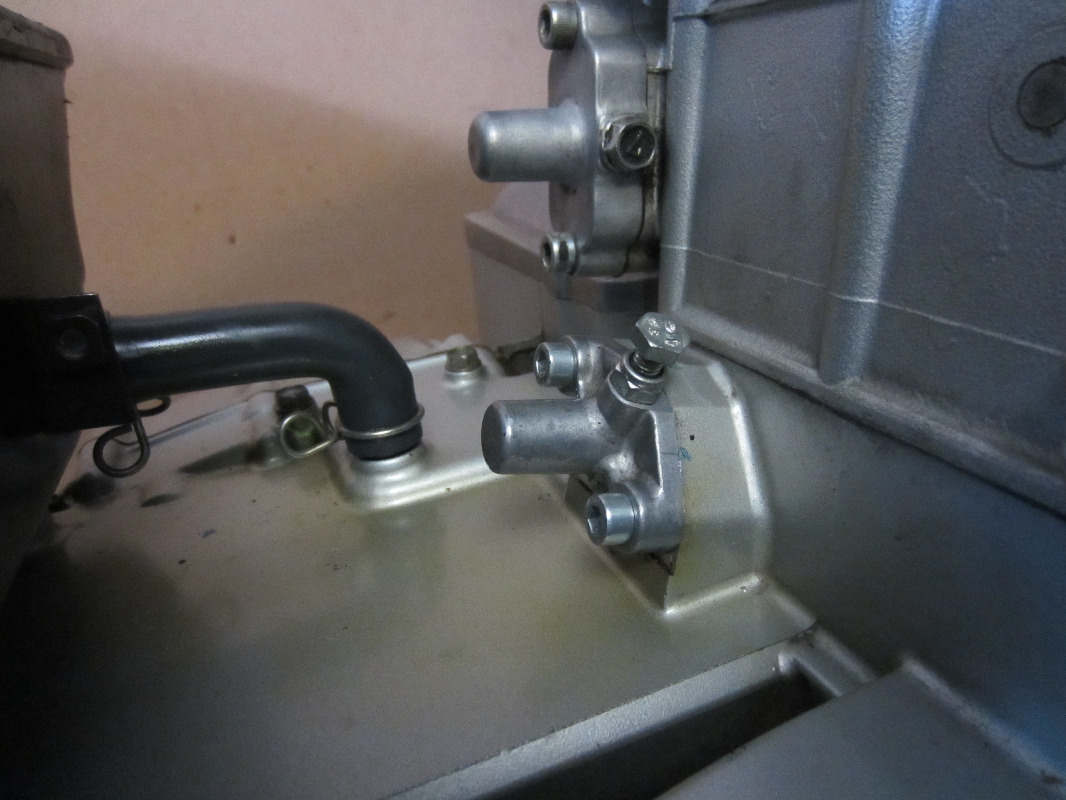

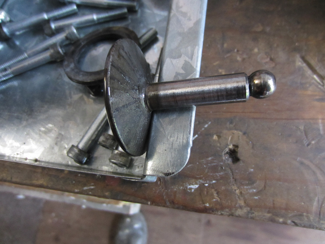

OK, so I dug out an old OEM auto tensioner (the type that fail), checked that the spring was within spec (min, 71mm long), installed it, released the mechanism, turned the motor over several times slowly and then made the same measurement – I was surprised that it was very similar.
With an addition of a longer 6mm bolt and lock nut, the OEM tensioner can be made into a manual locking type of adjuster with the advantage that (periodically), when you release the lock nut and bolt, you get the factory chain slack adjustment (no chance of premature wear on the chain, idler gear or roller)
This has previously been well documented in the Com, I am thinking about leaving it in and giving it a go…

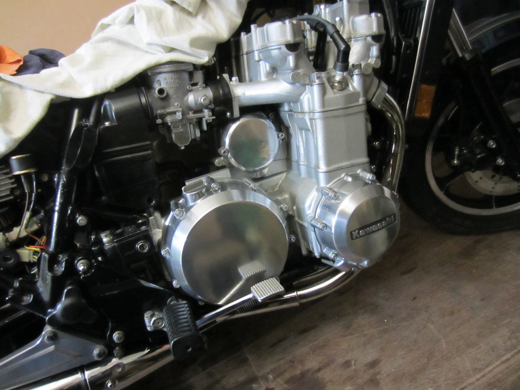

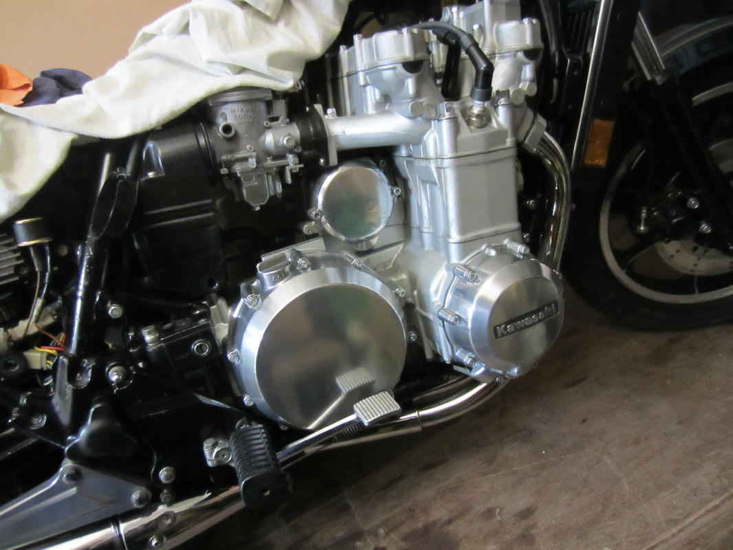

When I removed the clutch cover to clean and check the status of the plates and polish the cover, I found that the clutch mushroom was friction welded to the ball, it turns out that these parts have the same part number as used on the Z1 series from 1972 – to at least 1979 and after rummaging through some old parts bins, came up with the required replacement parts without leaving home.
It’s a pity that the clutch plates aren’t the same as well, because mine are just about on the service limit
I went for the satin over the mirror finish on the covers, this is #200-ish paper applied wet with kero and then hand polished with autosol.

Looks like you've got a beautiful bike there almost looks like it just came out of the showroom congrats.

Good interesting write-up. A good thing that you discovered the cam chain roller condition too. Now that it is running properly, what is your opinion regarding performance and general riding experience?

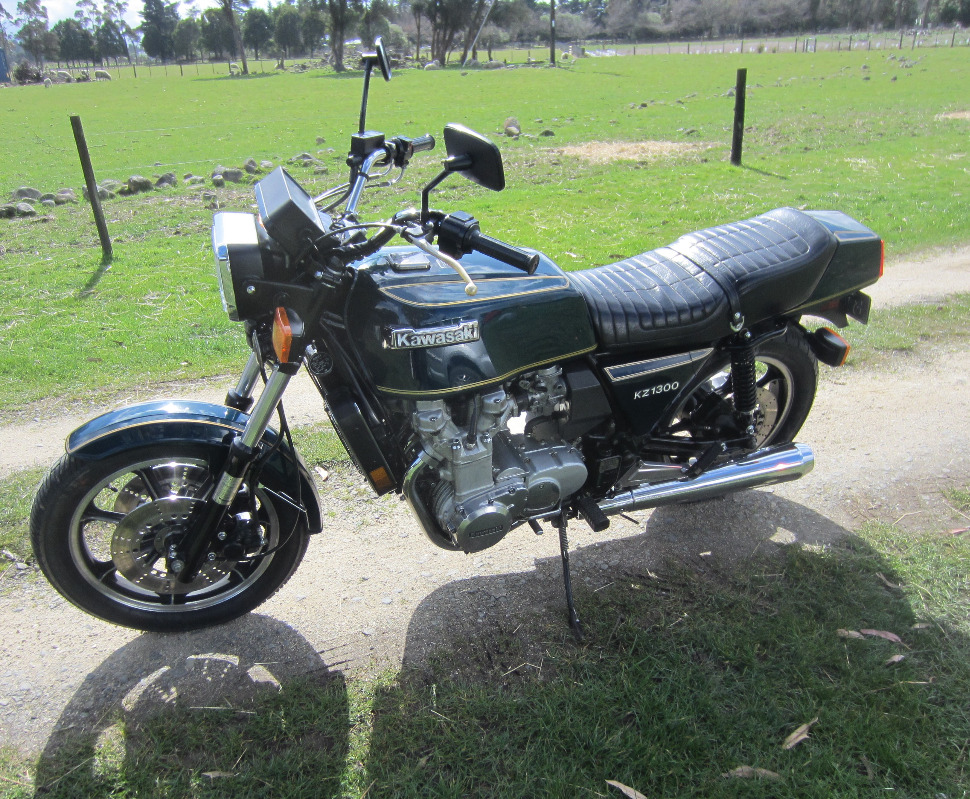

Yes, I have always liked the big bulky look and sound of the Z13 (as they are known out here) and always meant to eventually get myself one – although, it’s easy to get distracted by life circumstance and that is why it has taken me 40 odd years (ha, I am running out of time to get all those old bikes I always wanted).
I had previously ridden (a mates) one back in the day, and riding this one brings it all back.
I particularly enjoy riding this bike, running with the standard suspension of the day (1979) is a good reminder of how far bikes have progressed in 40 years.
As you know… it is surprisingly light and agile through mountain road corners with a good tractable power spread (ground clearance could be an issue if you are in a real hurry - which these days, I don’t seem to be).

Lauri Nurminen first brought that method of locking the standard CCT to my attention a while back & it's the way I'll be going when I swap out the ZZR1100 one on mine, luckily I kept the original CCT. Good work BTW
