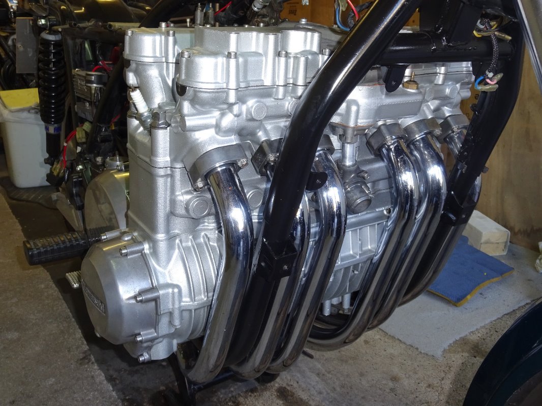

Yes, shame that the radiator covers the headers as it looks so much better without (see pic). Worth noting that the radiator has to dissipate around the same amount of power as the engine at its rated condition - so 120-130 hp or 90-100 kW. However, this level of heat rejection usually occurs at very high speeds so there will be a good flow of cooling air. The most challenging condition for the radiator is relatively low speeds and high loads - such as long uphill gradients in very hot weather. I am sure our 1300's would also benefit from a more powerful electric fan for those hot days in stop start traffic. Even more roasting for the rider!

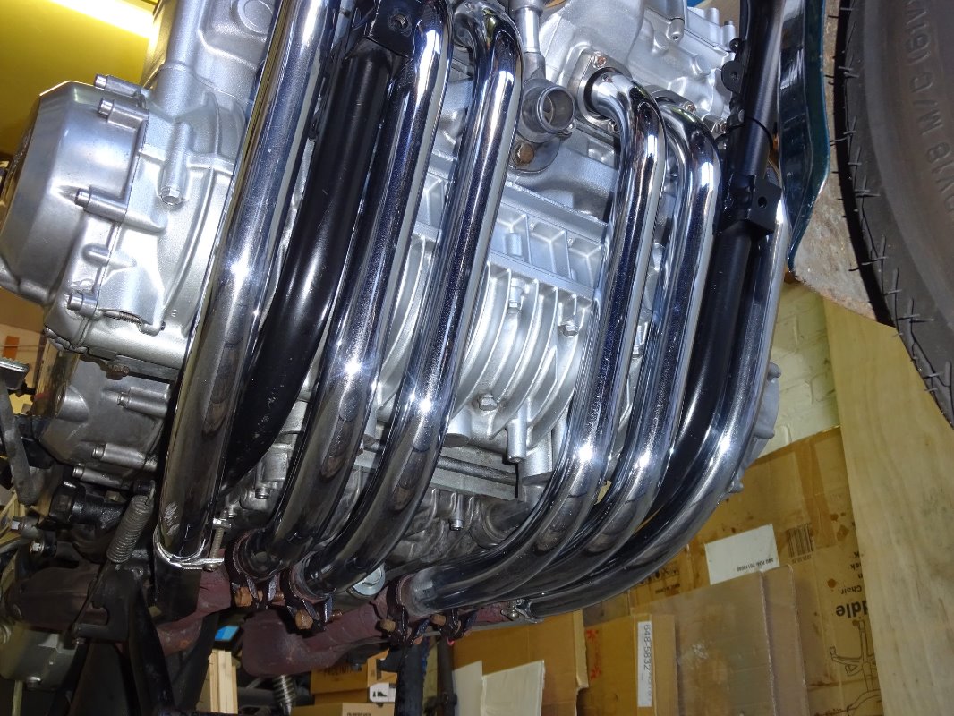

5 years 10 months ago - 5 years 10 months agostrate6 wrote: Dont let polishing put you off mate..............
Even with Black Pipes, they still have a massive presence !!
Its just the sheer size and width of the motor with six pipes that makes it stand out from the rest (little 4 cylinder bikes) HAHA !
Are those pipes ceramic powder coated? If so, wondering how durable the finish was. I'm working on another bike right now that has an OEM black chrome pipes which are now sadly in need of a new finish. Considering ceramic powder coating but around here, the durability of that finish has mixed reviews. I've used the ceramic high temp paint on exhaust pipes before and found it reasonably durable but it only lasts several seasons - but 1/10th the cost of ceramic coating.
