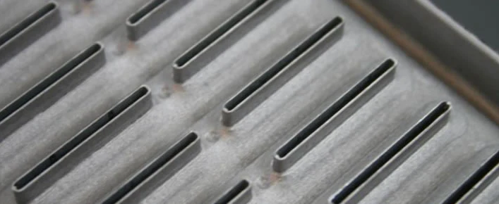

The tubes are still blocked. ????? The oval shapes SHOULD BE the ends of the tubes and they should be clear, not blocked with lime like deposits.
this is what a radiator core should look like before installing the upper and lower rad tanks.
this is a better picture of what the tube core ends should look like

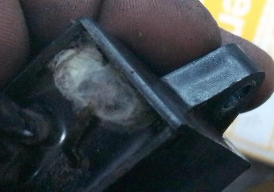

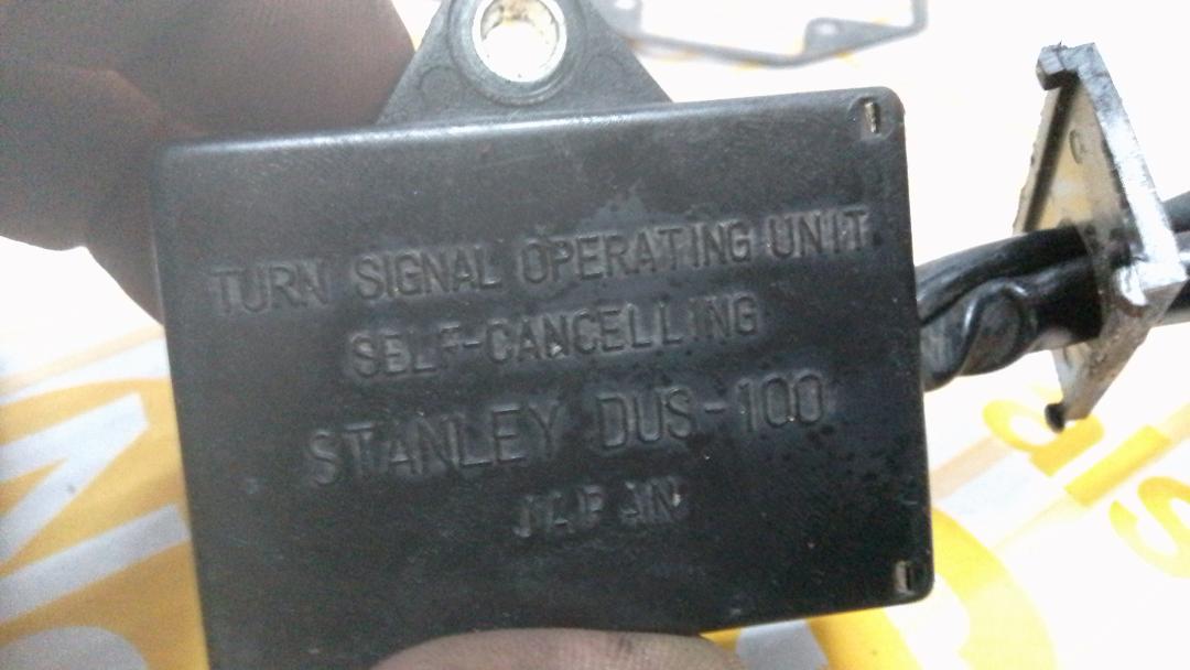

I began to join cables from the electrical system until I reached the automatic stop of the indicators under the battery holder that I have never seen work when I started the bike.
Can this part be repaired or should it be replaced with a new one?
Mine has a spider nest under the plastic cover.

Have you proven it to be bad?
I doubt repair is possible, I tend to recall it's a sealed unit.
Sure, you might be able to cut it open, but what's your time worth when they are plentiful and cheap on eBay ?

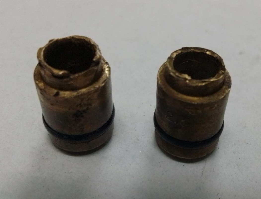

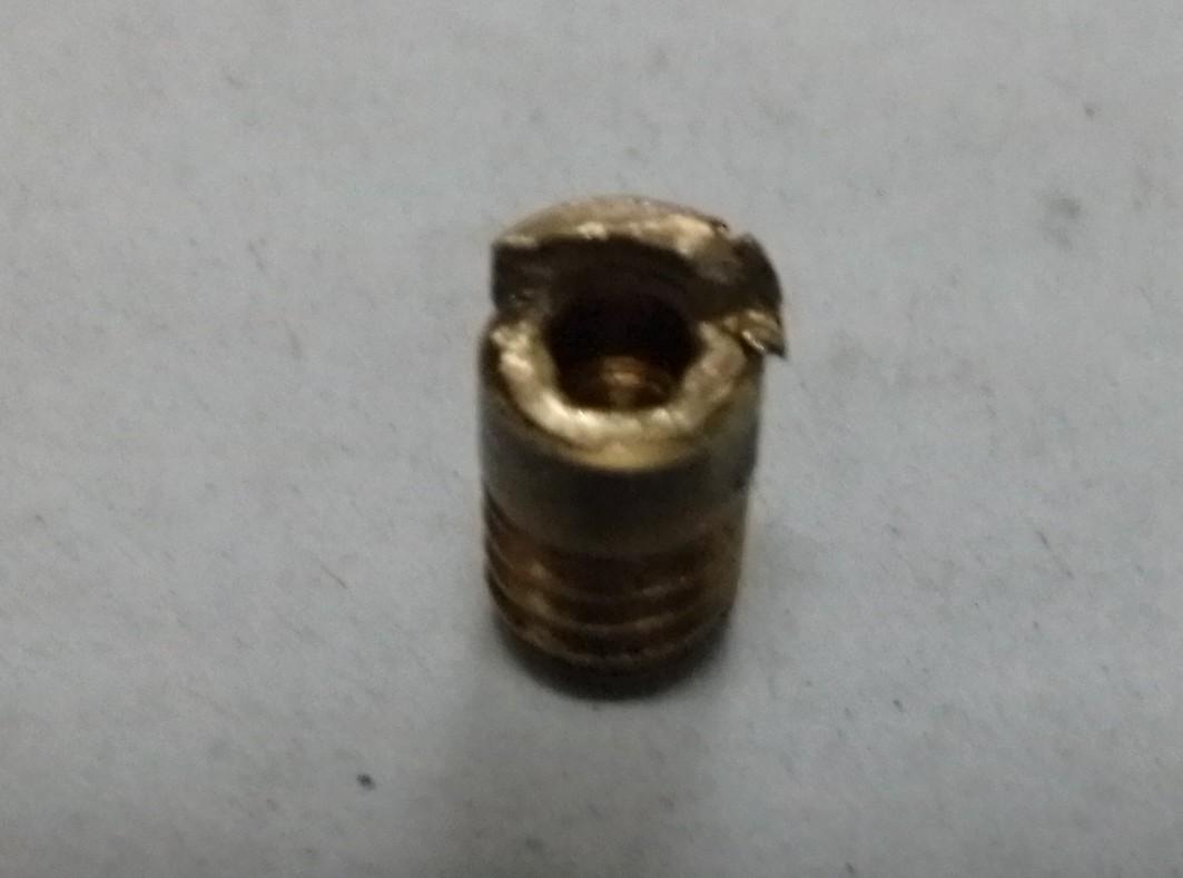

Some parts were very bad like this jet.
These two pieces had already been disassembled more than once, the strange thing is that they closed well and did not flood the carburetors.

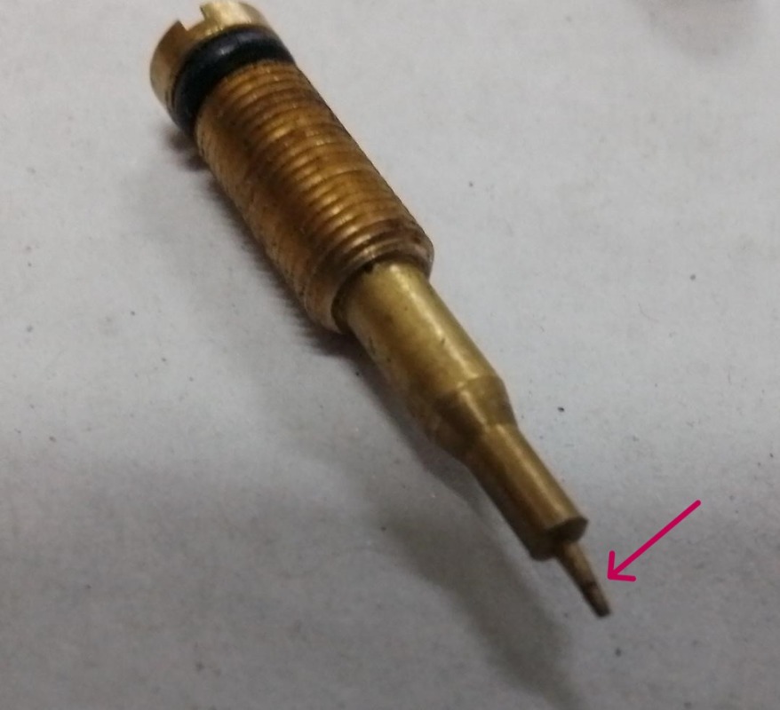

One of the air regulation screws had a slightly bent tip, it has already been replaced.
Regarding the air regulation screws, I found them adjusted between two and a half and two and three-quarter turns from their tightening and I left them that way once they were changed.
It is a correct measure.
