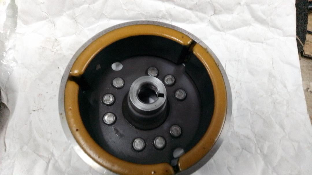

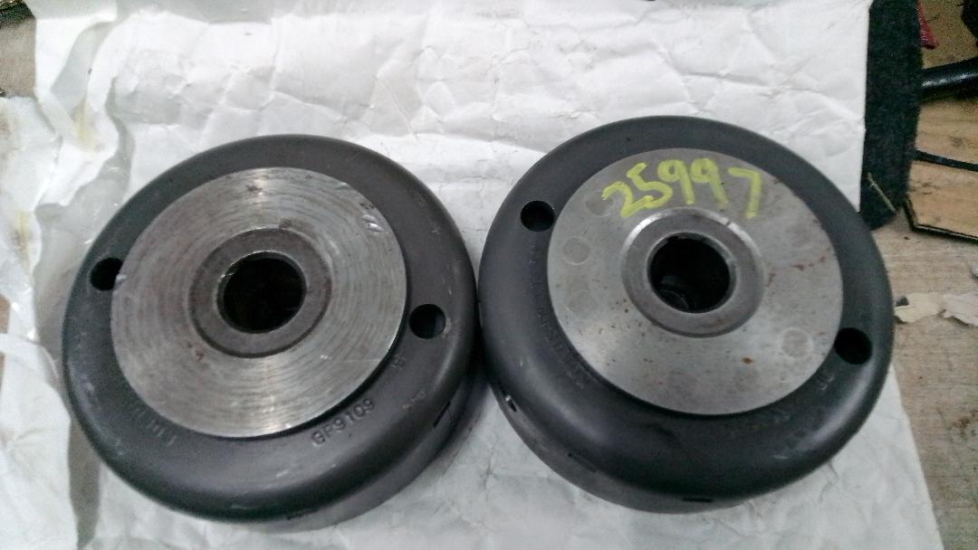

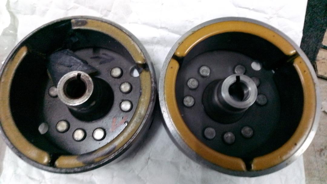

Today I finally got the rotor from Australia, it took only a couple of weeks, blessed globalization.
It looks much better than the old one, and not just because of the broken magnet.

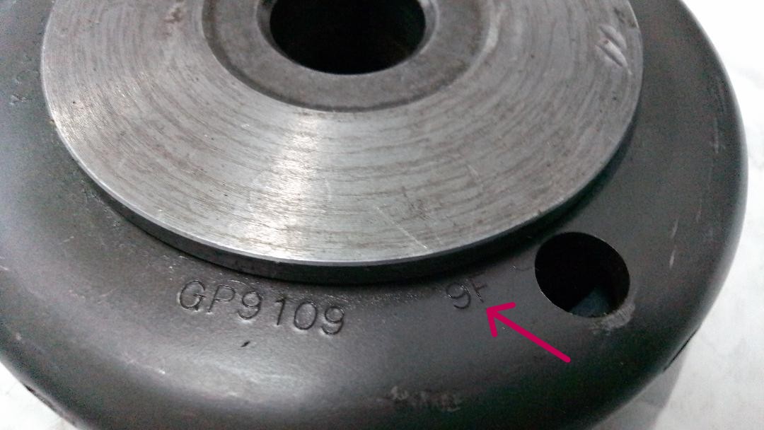

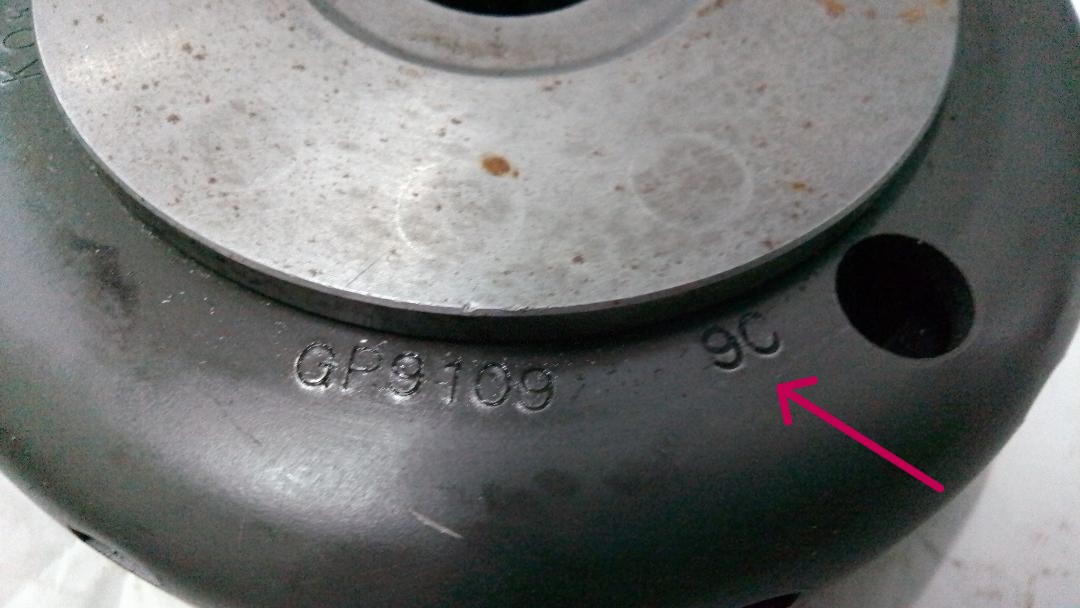

The reference numbers match except for one letter, on the broken rotor it ends in 9F and on the Australian rotor it ends in 9C.
Should I be worried about this difference?

Is the taper the same on the new one? the outer aperture looks smaller on the replacement.

I'll suggest that the reference number refers to a batch number. Quite often parts that come out of a foundry get assigned a batch number so that components that fail can be traced if necessary to the batch so that if the failure is related to a foundry problem, other components in the same batch can be pulled from service.
Usually foundry numbers will indicate the year and the batch number. In this case "9" would be the year "1979" or possibly "1989" and the batch would be "C" or "F".
I would say if the rotor fits, you're good to go.

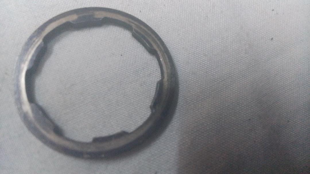

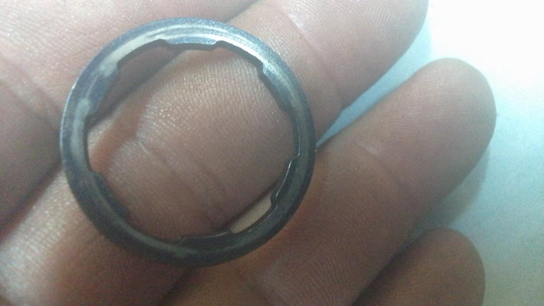

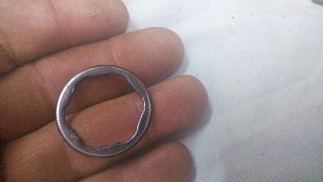

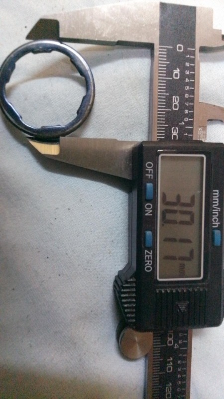

When I disassembled the motor I put all the parts in boxes, primary shaft, secondary shaft, chains, etc.
I found this washer on the floor of the workshop among the boxes of disassembled parts, I do not even know if it belongs to the bike or where it would be placed. Can anyone identify this part?

10 months 1 day ago
Looks like 29 in this diagram:
Transmission Parts
