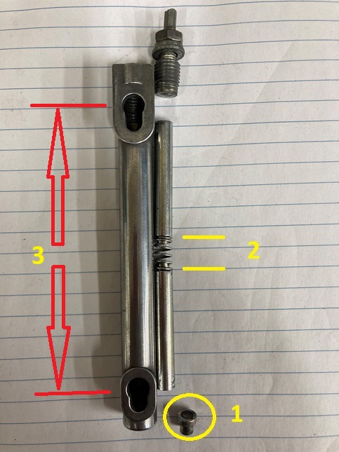

I pointed out your sync. adjustment screws appearing to be too far out. This could be a result of the bottom “Ball-Seat” not being correctly positioned.
It’s easy to miss this when assembling the link-rods. #1
A small bit of grease will hold the bottom ball-seat in place! If this piece isn’t positioned properly, (upside down) it will move everything higher within the rod and this can account for the excess number of threads showing above the rod, itself. It might even be that 1 of the 2 ball-seat Pins have been installed upside down.
Adjusting the Sync-screw changes the distance between the Main throttle Shaft Ball (Top) and the Carb-shaft Ball (Bottom) . #3 Because the Return Spring on the Main Throttle Shaft is Stronger then the Carb Shaft return spring (for the Throttle plates) any adjustment will open or close (respectively) the Throttle plates.

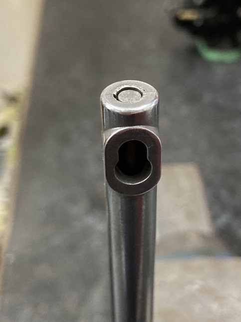

Finally had a day to get this figured out.

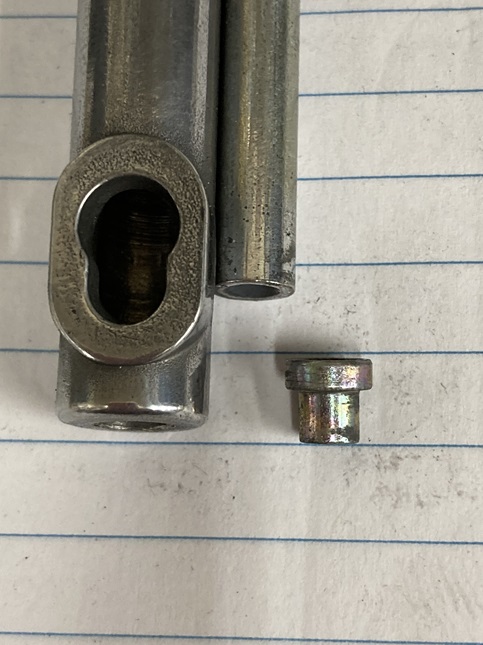

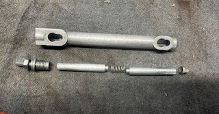

I took off one of the rods and wanted to double check that I installed everything correctly.
Turns out I did install everything correctly.
Here is what it looks like as I removed it. I removed the remaining 2 rods and they were the same.
Then I spent some time getting the static synch setup.
I cut up some strips of envelope material about 3/16" wide and measuring at 0.006" thickness and inserted them into the butterfly valves.
After some fiddling,
There is .006" gap on the butterfly valves.
There is a gap at the choke cam and roller, the hard stop is now open, and only a few threads showing on the adjuster.
I think the reason why I had so many threads showing on my earlier pics is because I used a much wider steel feeler guage,
(maybe 10mm wide) on the butterfly valves and it held the valve open way more than the .006".
Once I put the thinner strips of the envelope material into the valves, it all came together to make more sense.

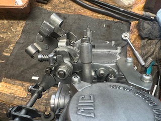

With the choke set at the highest point on the cam, I set the idle at 1.5 mm or 0.059, slightly more than the .54-.55 as stated in the manual.

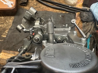

Last pic shows the choke cam just beyond the the highest point, with clearnace, which is the same as idle position.
