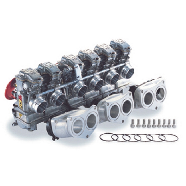

Someone developed a manifold for a twin choke Webber carburettor. Not sure if it is being produced.
A Japanese company makes a set of 6 separate carbs and adaptors but REALLY expensive. FCR I think?

If you have the money...
Available with the adaptor manifolds straight from Japan.
japan.webike.net/products/21724102.html
Only like $3200.00 or so... :pinch:
