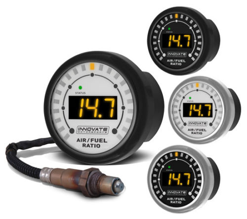

There's no denying that a really good fuel injection system will out trump a carbureted system but what's involved in a "really good system". The Kawasaki Zn1300 system maps out the fuel pulses based on manifold pressure, throttle position and ambient air temp. This is somewhat primitive. A "really good system" would have a mass air flow sensor engine temp, ambient air temp and what I consider the most critical part an, exhaust o2 sensor. The feedback from the o2 sensor is the after the fact monitor which feeds back to the computer how everything's working out and based on what the o2 says, the computer will adjust the fuel map to meet programmed parameters.
I've considered the BMW throttle body option and strangely enough the DIY computer and possibly welding in sockets to install 14 lb. injectors near the inlet valves but this undertaking is not for the faint of heart. I've chosen to go in a slightly different route and stick with the carbs for now and add a o2 monitoring system onto the exhaust system which will continuously monitor the exhaust and display the results on a gauge which will be mounted up near the instrument cluster. In effect, I'll be able to see how well the jetting is set up under all conditions and be able to determine the best all round setup for the main jets and the main jet needles. So in effect, I'll be the "computer" which determines whether the carb system is running rich or lean then I'll be manually adjusting the carbs to get the optimum fuel mixture under most running conditions. The o2 monitor cost me around $250.00 Canadian which is more than likely 1/4 of what it would cost for a fuel injection system that would out perform a well set up carb system and it will give me continuous feedback on how well things are running.
Here's a pic of the o2 gauge for those interested.
