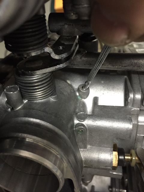

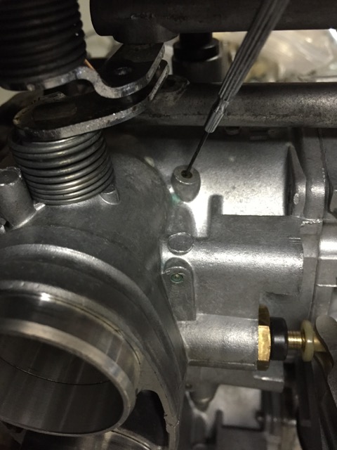

Here are two photos.
You can see how far the small screwdriver slides into the passage. On the other carb the passage blocked after appr. 8mm. Out of this hole the air is coming out when I blow into the passage from up where the idle air adjusing scrwe is normally in. Another question I have is: Do I have to cover up the idle air adjuster screws again after adjusting (3 1/2 turns out right?) with something? Or can I leave them open?

Forgot to say: It's the middle carb which has an open passage.
Karl

Re: 1982 Carb missing plug in idle air circuit
9 years 11 months ago - 9 years 11 months ago
These holes are blanked off about four or five mill down on my carbs. Looks like you've lost a blanking plug.

Ok,
thanks for clarification! So I have to block that passage again with something. What should I use? JB Weld or a little screw or a ball from a small ball bearing?
