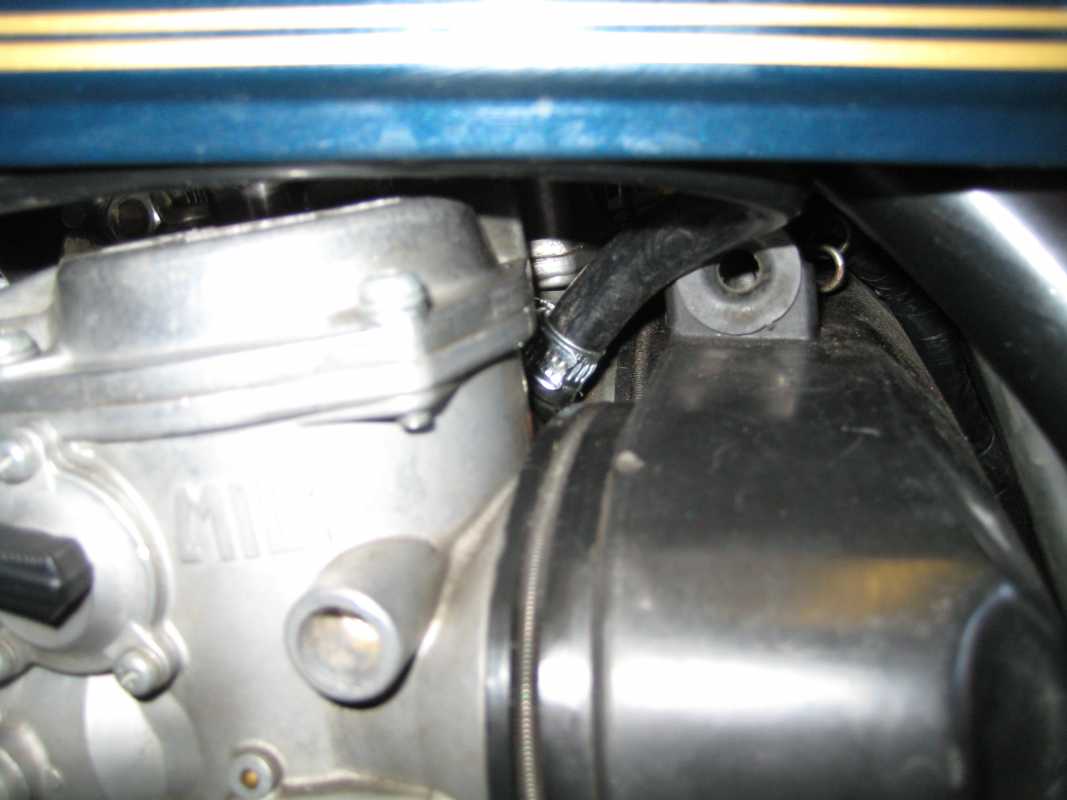

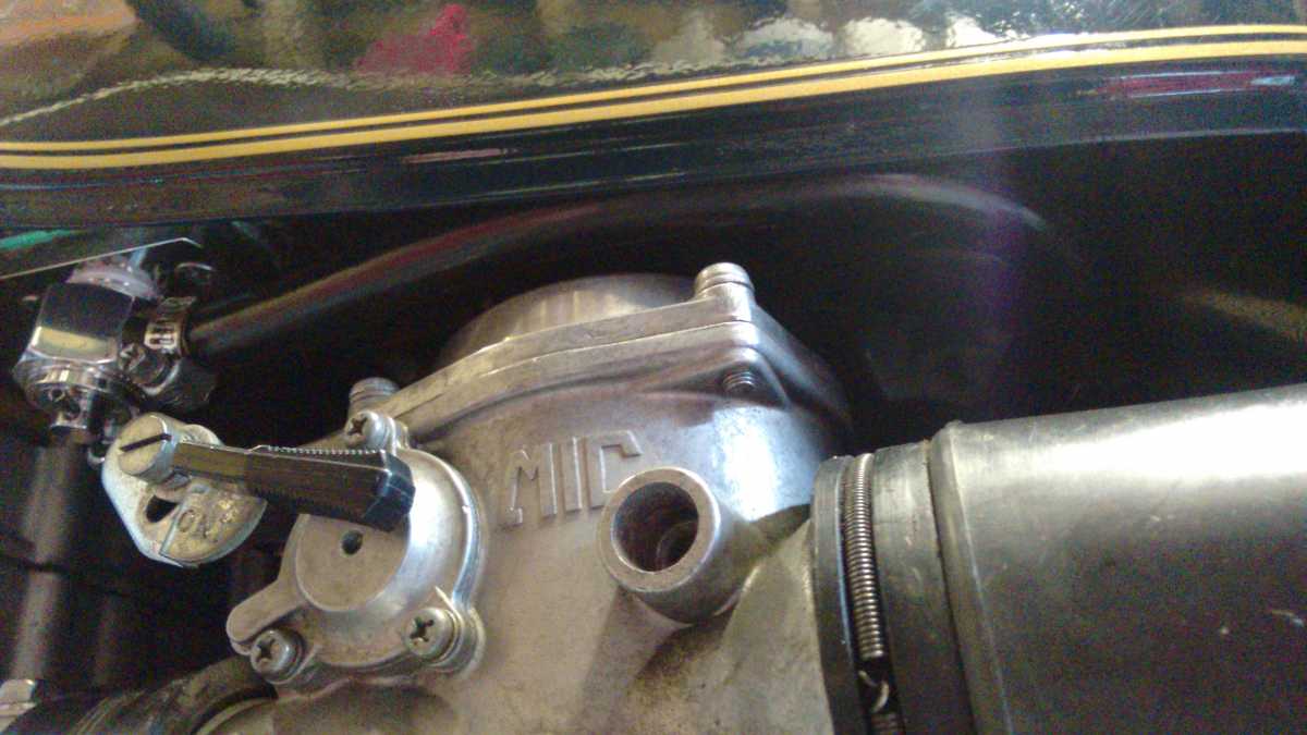

I had a similar problem, fitted a pingel fuel tap, turned it so the outlet faced towards the back wheel, turned the carb inlet upwards -instead of down- this set up gives you the shortest possible fuel line. No in-line filter, I just rely on the filter on the fuel tap.
No problems with this set up so far.
