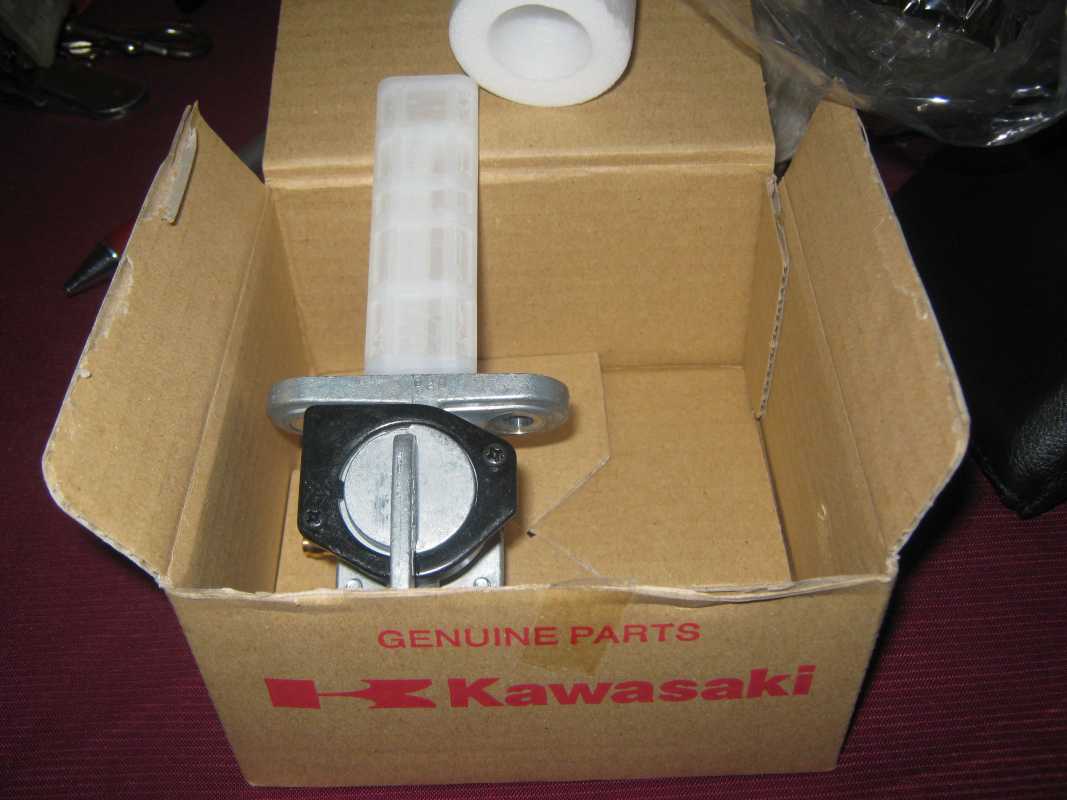

[quote="dcarver220b" post=14275
Off to Pingel or Suzuki.
What's the opinion of using the Suzuki petcock, vacuum?
www.z1enterprises.com/product/KL18-4358 [/quote]
Suzuki vacuum petcock ??????????? , I have a Kawasaki vacuum petcock installed, forget what model it's off but it fits straight on, there's a thread somewhere on here about which one to get, cheers Pete.

Hi Pete
that kawasaki replacement fuel tap looks ideal, unfortunately i cannot find a thread with any details on it so if anyone can I.D i would be grateful
many thanks
Paul
many thanks
Paul
