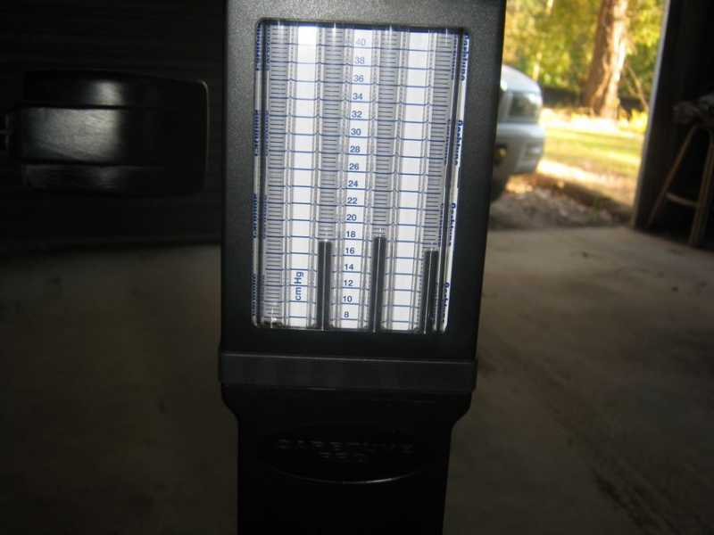

I've looked everywhere, there are tips on how to balance the carbies, but no info on what they should be set at, here's the gauges when idling after the adjustment, well I did get them a bit closer after the photo

Hi Pete,
I know my way around an engine, pretty much, but I'm glad I don't have to make a living at it. I'll take a crack at your questions. I'm sure there are others out there more experienced than me. So if I get off course too much someone set me straight.
So far I've been fortunate in that I've not broken anything significant. However I have muddled around with these carbs too long.
Regarding rejetting. I had to rejet my 1300 after I installed the same exhaust system you have. If your bike is running well and the color tune plugs are not telling you it's too lean, you're probably good to go. If not these folks have what you need: www.dynojet.com/jetkits/ The stock mains are 110's. The next time I pull the carbs I'm going to go with 100's for the mains and the clip in the third notch. I think that'll get me sorted out, but I've thought that before.
I looked around for the fuel octane specification but couldn't find one in either the owner's or service manuals.
I believe the goal of the carb sync adjustment is to get equal numbers whatever they may be.
Your small deadspot might be an indication of a lean condition in the idle circuit. The starting adjustment for the idle screws is 1 3/4 turns from seated. Mine are at 4 turns out. I believe the conventional wisdom is 3 1/2 turns.
Regarding the intake, leave it alone! Unless you really have to.
The air box is your friend. It also convinces your three sets of twins to get along. Go ahead and put a higher flow filter if you want but keep the airbox if at all possible.
Hope this helps.
Bill

I still can't understand why there isn't a "minimum" setting for the vacuum gauges, the ideal sweet spot, I think about it and it makes me wonder, logic tells me that if you set it "high" then the vacuum will raise the slides, so that's why I asked about it. There just has to be a setting somewhere that you would try and get the flow right, or else the higher the vacuum the higher the slides would be, it's just how they work. If there isn't a setting to try for then what would stop you putting it anywhere you want to ???, still confused

Hi Pete,
Getting the flow right isn't important. Getting the three carbs to flow the same amount of air is. I believe the vacuum is supposed to be within 2 pounds of each other.
When adjusting the sync on these carbs we don't really care about the absolute vacuum. It changes every time you open or close the throttle. All we care about is that as the vacuum changes each carb experiences the same amount of vacuum.
Bill
Bill
