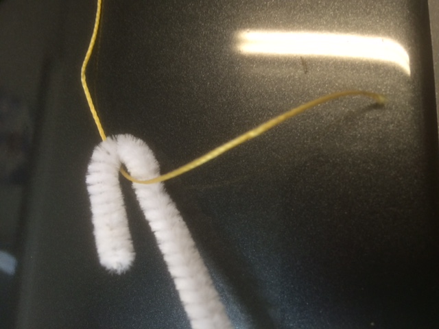

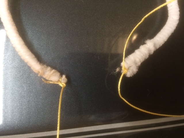

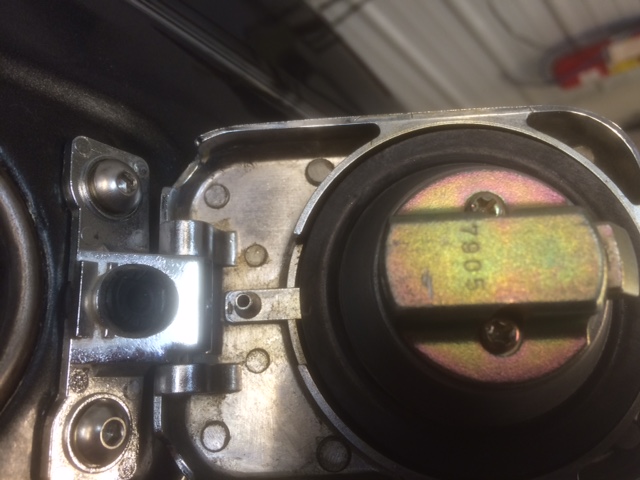

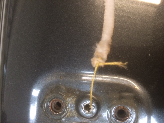

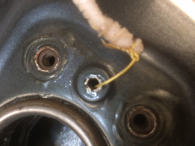

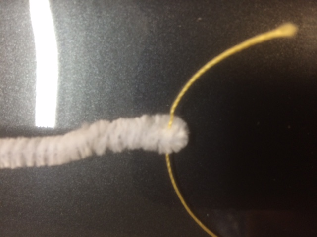

The fuel tank must be vented to allow air into the tank as the fuel level decreases. Conversely, if the tank is full to the top on a hot day, the vent also acts as a fuel over-flow. The grommet that seals the nipple to the cap must be in good condition ! Not so important for replacement air to come in as the fuel level drops, but really important for an "over-filled" condition in order to get the excess fuel to the ground via the vent hose rather then leaking from the cap and having that fuel run all over the tank and engine!

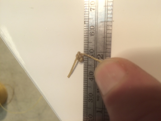

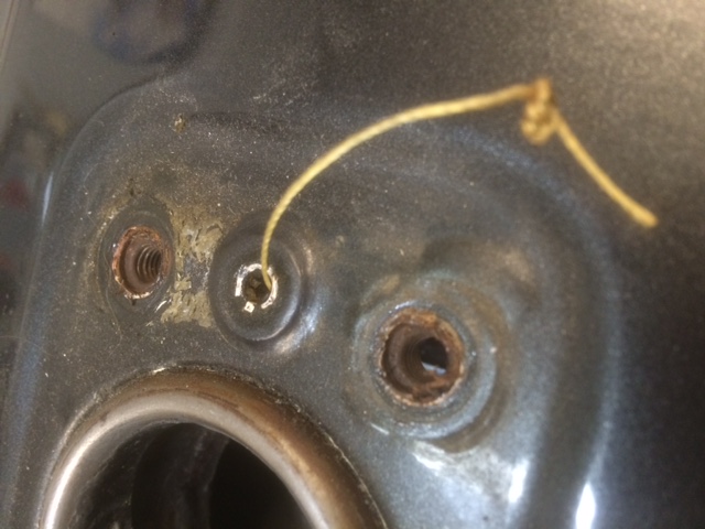

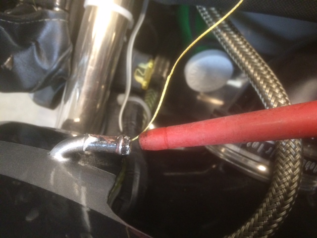

Pictures are my '80 fuel cap. I had my cap completely apart years ago to de-gum the lock and don't recall any issues in disassembling or re-assembling it. It appears that Kawasaki changed their design slightly.
While on the topic: You can ensure your vent is clear by running a pipe-cleaner through it. Pictures are self explanatory. Note: Use some tape or place a rag in the open filler when re & re'ing the cap to avoid dropping the cap attachment screws into the tank ! Make sure your string-knots and the twisted loop in the pipe cleaner are secure ! Both ends of the pipe cleaner should be "strung". This way, If one end comes off in the vent you can pull it back out with the other end! To get the string through the vent tube, Tie several knots in one end of the string, insert it into the vent and use compressed air to blow it through. Works like a charm. If it won't then you either have the knots too large or there is an obstruction which will require you to reduce the size of the knot until it will pass through. Use a white or light colored pipe-cleaner to witness any debris. You might be surprised what comes out !
