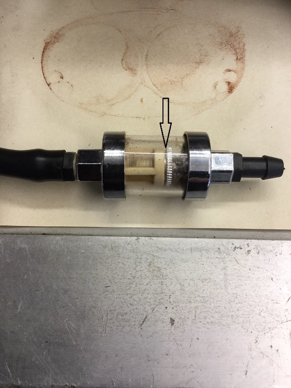

If you look at the previous picture of the fuel filter you'll notice that the knurled nut is 2 to 3mm away from the plastic body that houses the filter mesh. Effectively, it was allowing fuel to by-pass the filter directly into the carbs. This has now been cleaned and reassembled correctly so there is no gap between the knurled nut and plastic body. Its worth noting that it was fitted directly out the box so it's always worth checking things are assembled correctly before fitting.

Regarding your fuel filter - I thought I'd try the same one some time ago, and it never made it onto the bike. nuff said !
Again - I'll suggest you buy a larger one from an automotive store. In your case a clear/translucent plastic body with a paper filter element. It won't cure your existing issue but will help in lessening the chance of errant debris making it to the carbs and creating more problems.

Last but not least, these carbs for whatever reason are extremely sensitive to debris. Most of the inline fuel filters being sold for gravity fed small engine fuel systems are typically filtering at 70-80 microns. There are a number of "better filters" available which filter down in between 10-30 microns and I really think we need to pay attention to what we buy and install on these bikes. The only downside to using the finer filters is that they may plug up earlier and could leave you sitting on the side of the road if they plug up. It's a double edged sword. Too coarse a filter and you take the chance of blocking the transition ports (which are the smallest ports in the carb) or run super fine filters and have all the debris getting trapped in the filter and take the chance of no fuel flow. I think you need to pay attention to what the micron filtering range you buy and be the judge on what you feel is appropriate. I like the 20-30 micron range and will monitor the filter. And I certainly would be shy about carrying a spare fuel filter with me for change out if stuck on the side of the road. I have pulled filters off and blown them clear with my mouth and reinstalled but then I had to taste gasoline for the next 6 hours. Where's Tim Hortons when you need one.
