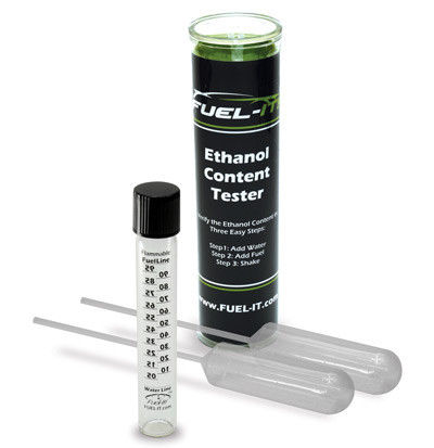

Good luck with that Stan. I bought an ethanol tester from EBay last week and decided to "test" all of the gas available in my area. I have an Esso station, an Ultramar station and a Shell station within 1 kilometer of my house. I collected samples right from the pump nozzle and tested.
Esso - regular fuel measured 5% Premium fuel measured 10%
Ultramar - the same regular 5% premium 10%
Shell - which is supposed to be nitrogen enriched fuel BIG SURPRISE regular 5% premium 10 % ethanol There is a belief out there that the premium fuel at Shell do not have ethanol in it and all of the guys in my subdivision have been told by their small engine repair guy to buy Shell premium and use nothing else in their lawnmowers, weed wackers chainsaws etc.
I have noticed that the tanker truck which drops fuel in Bobcaygeon IS THE SAME TRUCK seen at all 3 stations. You would think that if you bought fuel from a brand named company, you would be getting their brand. I know that all 3 gas stations here in Bobcaygeon are private owned stations and not franchised so I'm guessing that all 3 are buying fuel locally to reduce shipping costs and the common supplier is LiftLock Fuels out of Peterborough (45 Km away)
I guess what I'm trying to say here is "Do you really know what your buying these days?" This tester cost me $16.00 Canadian. Really it's just a 50ml test tube like bottle with graduations on it. You put in about 20ml of water and then top up with fuel. Give it a shake and let it settle. The ethanol comes out of suspension with the fuel and blends with the water and you measure the difference as a percentage as marked on the tester. Pretty simple.

Kawboy - I bought that tester as well, right after your first mention of it
I haven't tested yet, but of course I will.
I have no doubt there is cross contamination and from what you are saying the delivery by the companies looks to be on the shady side. I did some reading and apparently the Ethanol number is not written in stone from the beginning, but rather 'up to' a certain number, and that's on the hands of the fuel supplier. From what I gather, the gas stations are not obliged to check fuel for alcohol content. So it's really up to the fuel distributor - they mix ethanol into the gasoline. So, there could be cross contamination due to carelessness, or who knows, even intentional as ethanol is cheap and pure gasoline is expensive. Just extra 1% in a tanker would add up nicely. I'm not suggesting conspiracy theories, but look at the German automobiles scandals due to rigging computers in order to show clean exhaust gases. I'd bet someone somewhere would cheat if they could get away with it.
At the pump, I only buy if it specifically says 'contains 0% Ethanol'. Can I trust it? Not sure. But without academic lab testing, I guess my real life 'myth busters' type scientific experiment gave me simple results: using that proclaimed 0% - bike starts and runs smooth, using other than that - nope, or leads to 'nope' eventually. There is nothing else to it.
I usually go to Chevron, as apparently they do offer real ethanol free gas - which will be tested by me!
