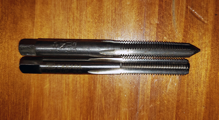

In the meantime, I just too a quick show and tell photo of two NF 1/4 x 28 I have. Quite different, aren't they?
Top marked England, bottom Canada.
