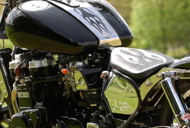

I built a 1300 chop some years ago & wanted a Stainless or Alloy Airbox making but could not get anyone to copy the top piece of the original.
I eventually found a company on Ebay who made battery boxes & airfilter boxes for rally cars (Mitsi's & Scooby's etc).
I sent him a photo of the top piece I had & he agreed to try making an alloy copy, which he did & it was perfect. The best bit was it was only £125 all in.
Went back a couple of years after to have another made & he had gone out of business unfortunately.
I think if you were to contact a similar type company you could get them to make you one.
Have a look at this on Ebay..........290910417827......maybe worth getting in touch & asking the question ?
Pic below of my chop with the airbox fitted......not the best photo but you see a bit of it anyway
