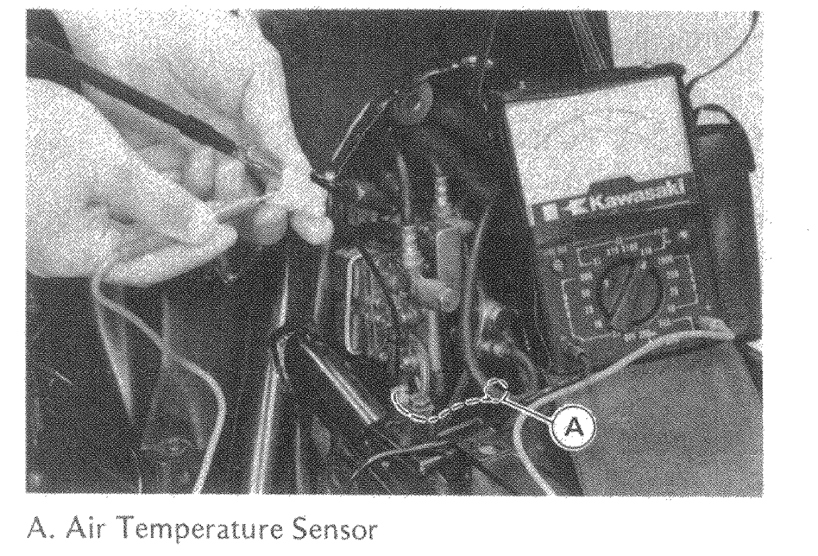

oldmanpepsi wrote: hi Kawboy ,,,thanks for the reply ,,,,i dont know which model i have ,,have ,,this is a trike which i have just bought as a project ,,how can i tell which model it is ,,also ,were is the air sensor ,,what does it look like ,, were can i get a workshop manual ,, i see different ones online ,,,,as i dont know the model i dont know if i buying the correct one

See pic for location. The manual doesn't say where it is, just the pic. The wiring feeding the sensor is 1 blue wire with red stripe and 1 blue wire.

On the ZG the air temp sensor is attached to the side of the airbox, so I would imagine it would be the same with the ZN Voyager.
