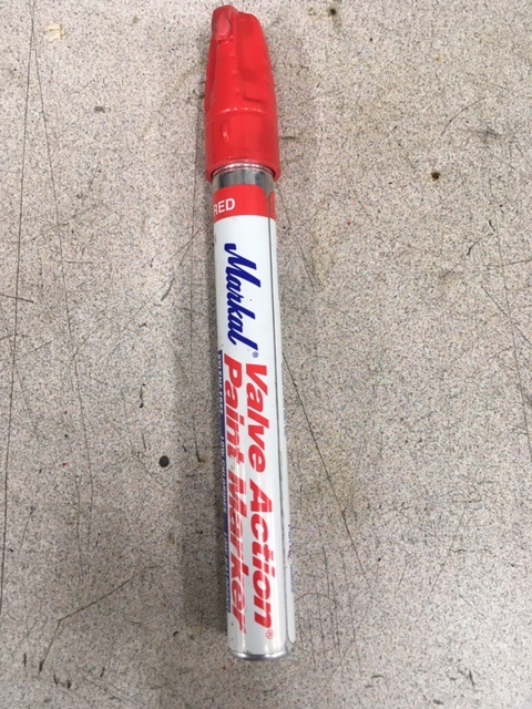

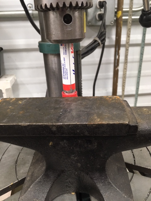

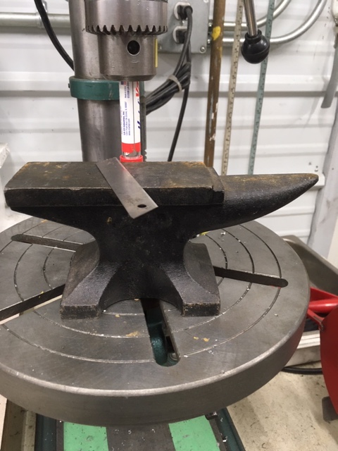

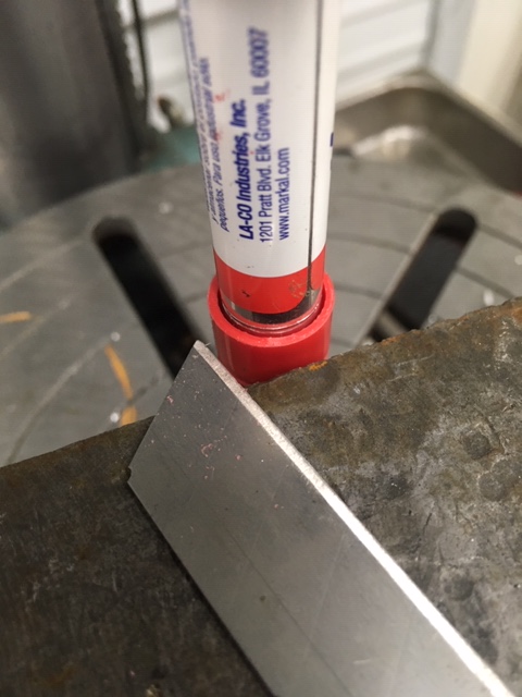

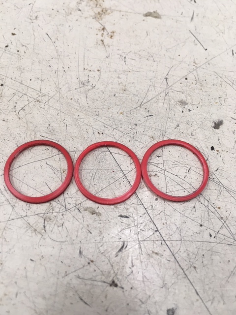

RE: The spacers (3) for the diaphragms.
These are almost impossible to find. None-the-less.....: Was using a marker this a.m. and had this brain-fart. The pictures should be self explanatory. I managed to get three parted-off; within several thou. which is close enough.

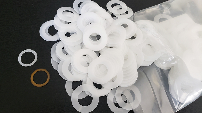

What an amazing society I live in, people discover that washing hands after coming home or after visiting a toilet is something you should normally do!? People are panicking stupid, but not all! The outpatient treatment center at the Vancouver General Hospital, which I have been visiting for a few weeks now, is one. The same casual black pants and t-shirt wearing male nurse, week after week, makes me wonder if he washed them in the meantime. Judging by the dirty sneakers he's wearing and looking like he just woke up, probably not.
As to the carburetor washers, it might be as simple as asking me. They are the exact stock inside diameter and thickness, and from the correct material. I can cut the outside diameter for you, or anyone handy with scissors - diy. 0ne thing for sure, I won't run out of them. Made in Japan.

PS.
Washers BY D0NATI0N . Shipping by location. PM me.
