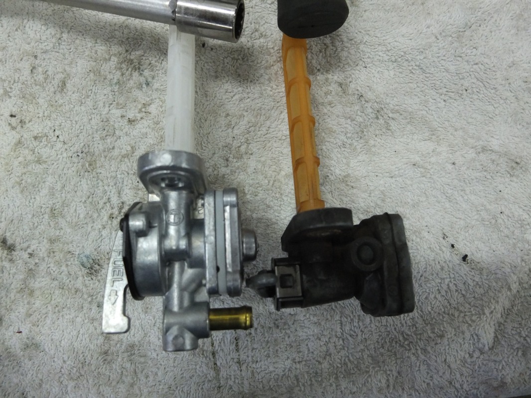

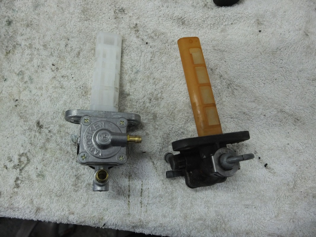

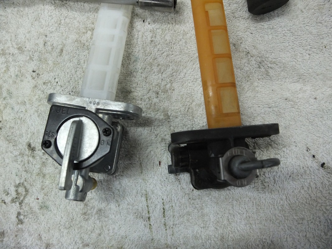

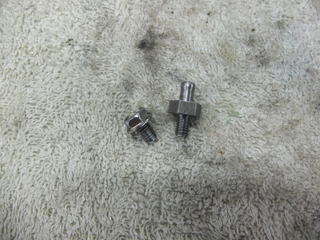

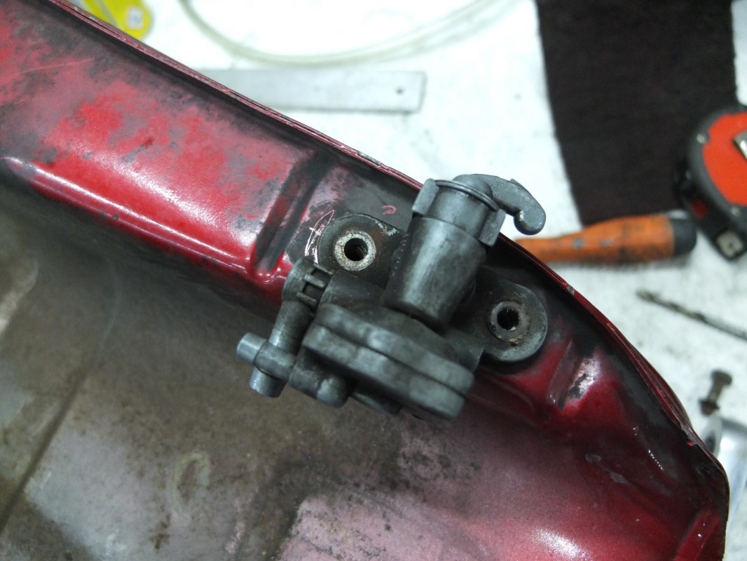

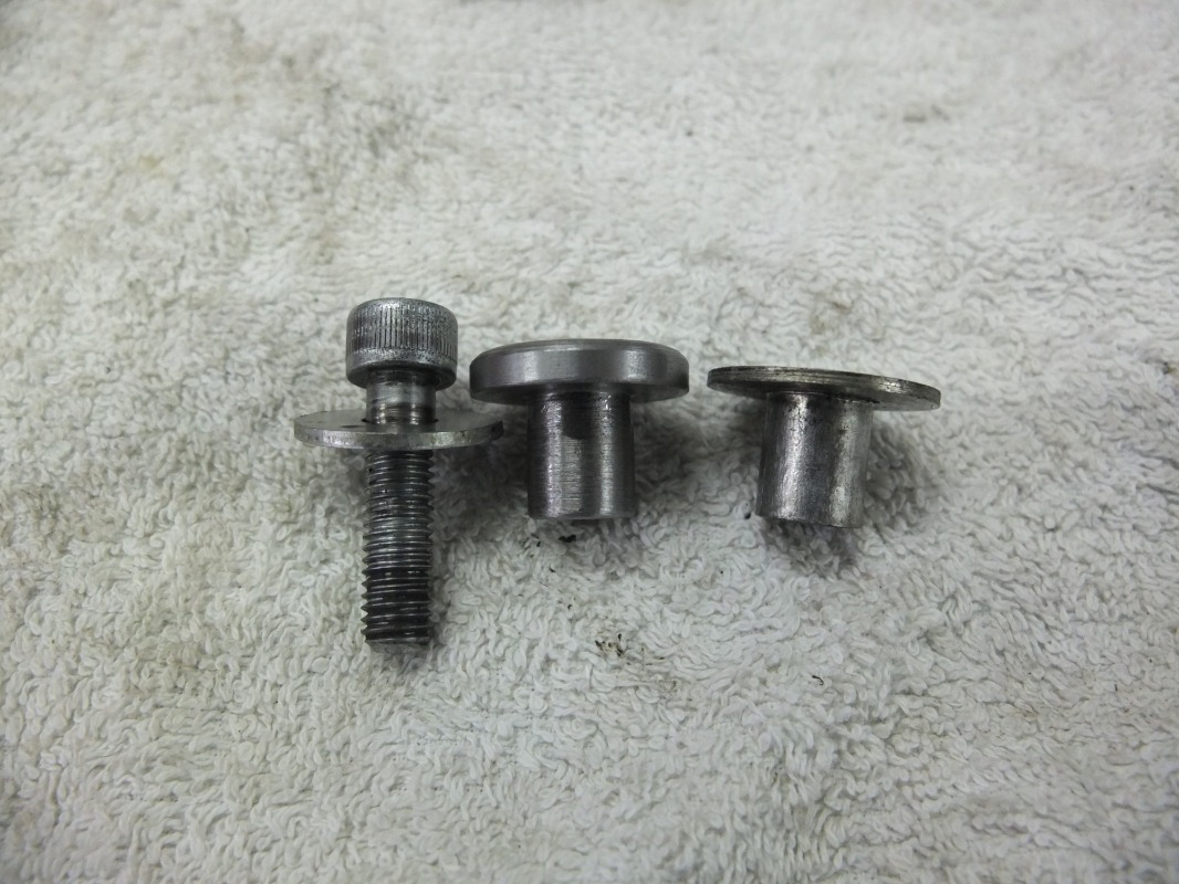

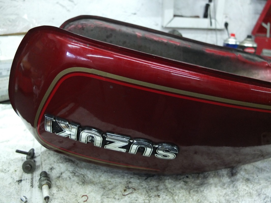

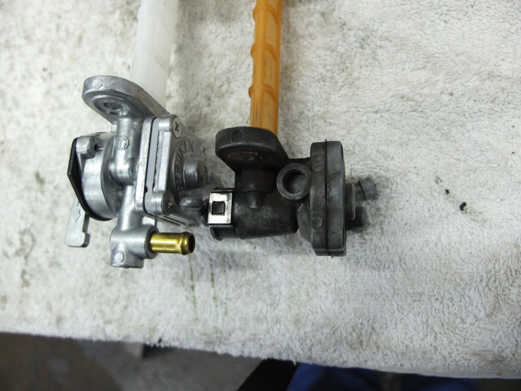

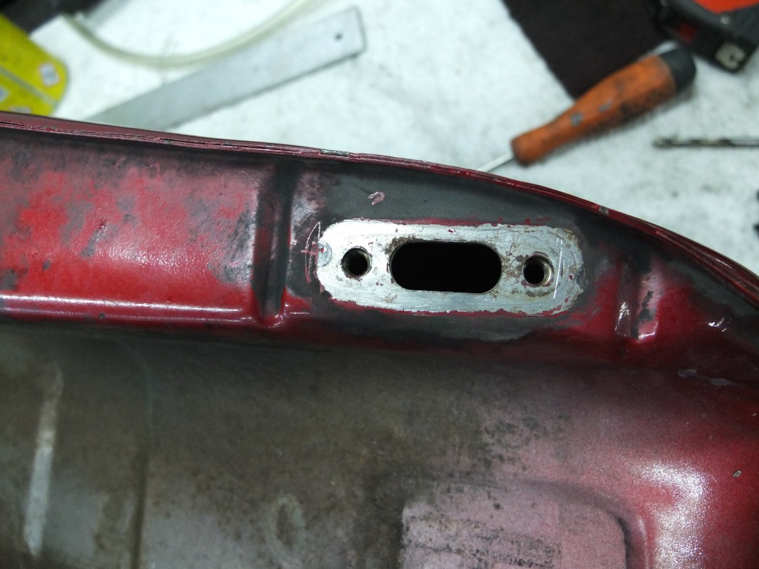

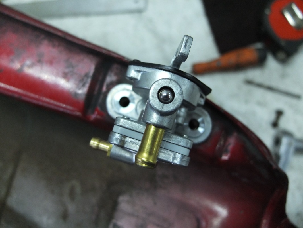

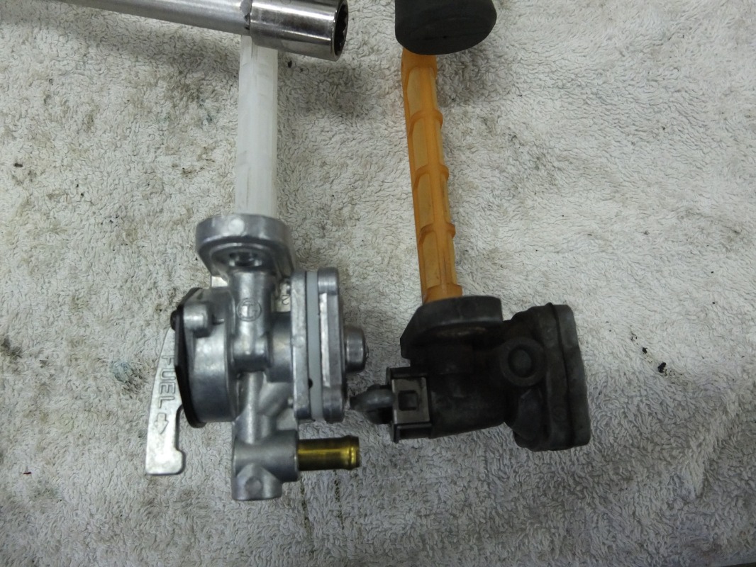

Instead of a GPZ or other Kawasaki gas tap, the tap on the Suzuki GS and GSX models can also be good. The photos show a new GPZ and an old GS 650 GT pin.
