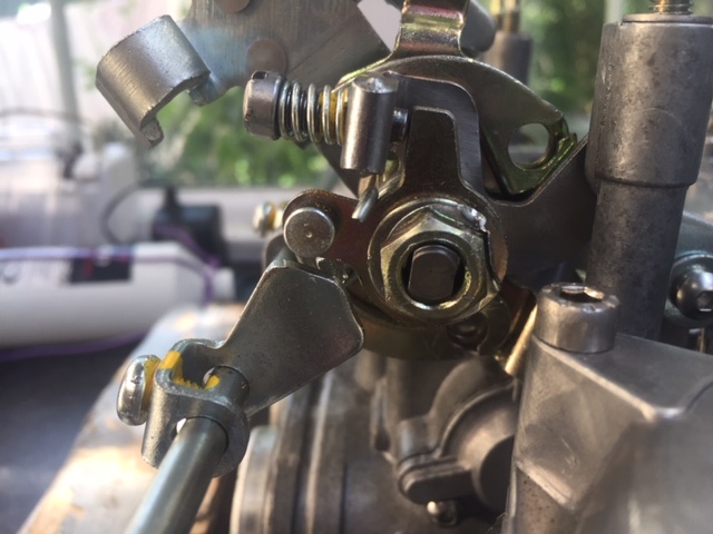

I see the locking nut is not on. When doing any of these static adjustments the nuts should be snugged to achieve a more accurate pre-determine end result. This however shouldn't be affecting the Fast idle adjustment. The fast idle screw is turned in too far. Turn it out to get the cam and roller gap correct. Forget the idle adjustment gap, for now. With the choke OFF, the roller should look like it's touching the cam but should spin freely. RE the Paper trick. Turn the adjusters in 'til they stop and back off 1 turn. Using your same weight of paper Double-up by folding with a hard crease, a 1/4" wide strip and try adjusting again. This is merely a static adjustment. The intention is to get the throttles roughly set in order to allow the engine to start and run ( to some degree) for the actual gauges adjustment. If you continue to find an issue with that one carb then you may have an issue with how that carb is aligned on the mounting bracket or something is not correct with that particular linkage rod.
We'll get it figured out !

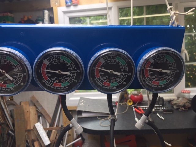

Hi Pete,
We have already spoken yesterday, but please let me thank you again for your help on the phone. She is running great now even though I have only set the mixture by the colour of the plugs as my Colortune is only coming next week. But I have equal vacuum across all carbs and idle is smooth. It still hick-ups a little when opening the throttle, but that may be because its not warmed up properly... and of course the mixture needs setting.
I am planning to take a bit of a longer test ride today, see how she goes, but essentially I think I am done apart from the new seat and the planned 6-into-six exhaust pipes. I'll start chasing those when Covid situation lifts and those companies have opened up again.
