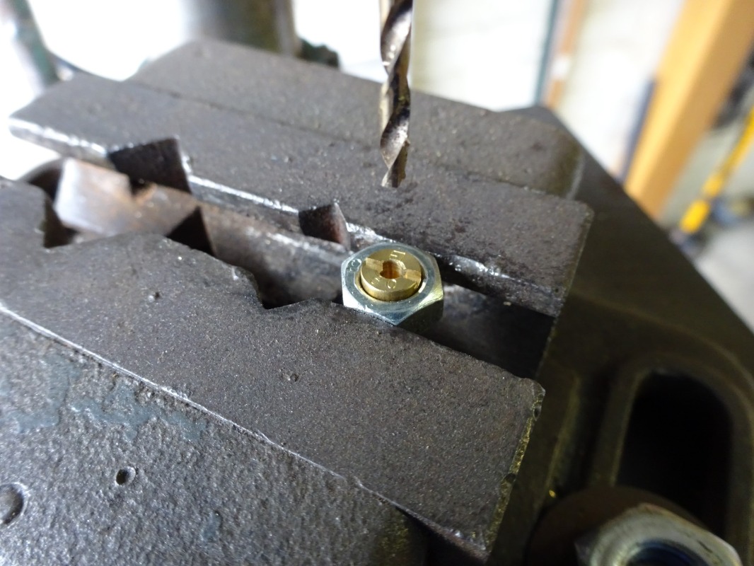

So after my trials and tribulations splitting the carbs, I finally got round to implementing the choke air mod as recommended by Scotch. To avoid any drilling or modification that I could not reverse, I went for the screw in Mikuni M6 jets. Unfortunately, I could not source the 240 sizes recommended so I bought 3 jets B42/55, 40 size and opened them out with a 2.4 mm drill. I would not do this for fuel jets as it’s probably not accurate enough but in my view, acceptable for air jets this size.
I dismantled the carbs one at a time and removed the floats, needle valves and jets and turned them over and removed the choke plunger valves, diaphragms and pistons together with the pilot air jets. I then tapped the choke air inlet hole in the upper body with an M6x1mm tap – as the choke air jet is slightly smaller than the recommended tap drill size, I found it important to make sure that the tap was aligned as carefully as possible with the hole centre - I just about perfected this by the time I got to the third carb – as usual! I also greased the tap heavily to try and keep any swarf attached to the tap rather than dropping into the choke channels. This worked to a certain extent but any remaining particles were vacuumed out using a plastic pipe connected to the end of my old vacuum cleaner. A few sprays of carb cleaner entered via the choke plunger hole helped to ensure that the channels and threads were clear of anything that might end up blocking or damaging the carbs/engine.
I then cleaned all of the jets and carb passages with STP Carb Cleaner – this seems to share a number of constituents with cellulose thinners or “lacquer thinners” as sometimes referred to as was very effective in cleaning the channels/jets as well as melting anything plastic including some of my protective gloves. I also replaced the “O” rings on the pilot jets as the 40+ year old originals had gone very hard and were probably leaking. (original “O” ring on left, new one on right)
I fitted the new air jets in place with a dab of thread lock as I did not want to over tighten and also did not want them falling out.
