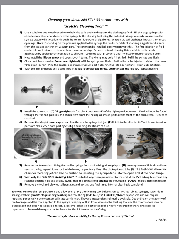

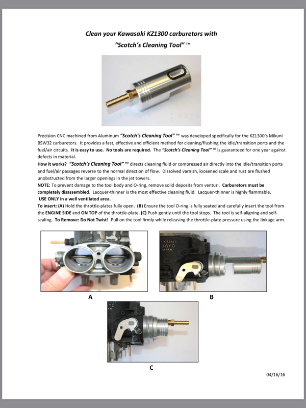

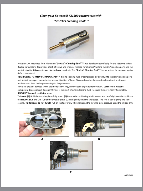

There are 3 ports. Have a read through this thread supplied by our Carburetor Guru Scotch. He should have been on the design team for the BSW32 Mikuni's. Maybe they wouldn't be such a bitch to work on had he had input on the design.
Off Idle Flat Spot Issues
You also mentioned that you borrowed a "Scotch's Cleaning Tool " from a buddy and cleaned the carbs. Did you follow the instruction sheets that come with the tool?

Thanks Scotch, I’ve just finished stripping and cleaning with your carb tool and rebuilding the carbs yet again. I was quite surprised how many little bits of debris came out and just how discoloured the thinners was even though this is the third time I’ve cleaned them. I must admit this time I did them exactly as your instructions where as before I might have cut a few corners lol. I’m not refitting the carbs till tomorrow so while they’re on the bench I’ll have a look at the pilot screws through my jewellers eyeglass.
Also while they where on the bench I’ve removed the enrichment diaphragms and put the cover back on with a gasket.
thanks once again for your input and patience. I’ll report back tomorrow when I fire her up again. Fingers crossed that I’ve sorted it.

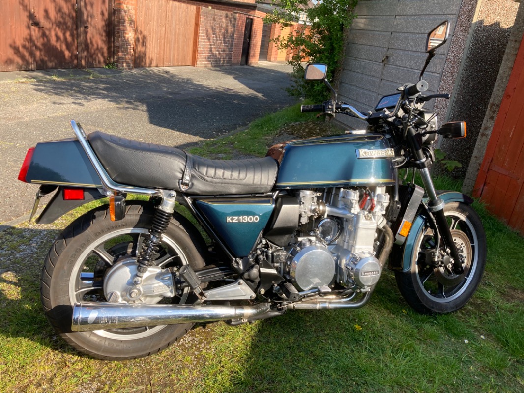

Well finally she’s running properly, bolted the carbs back on and after a bit of balancing she runs as sweet as a nut. The tickover is a bit fast and the adjuster is fully backed off so I think I need to redo the balancing.
Thanks to everyone for their input, hopefully i can just enjoy riding the beast now.

I've said all along, Scotch's Cleaning Tool is a well designed piece. There's no trick to using the tool but following the directions provided with the tool is the difference between doing it once and getting it right or fighting Pilot Circuit blockages tooth and nail as this thread has proved.
