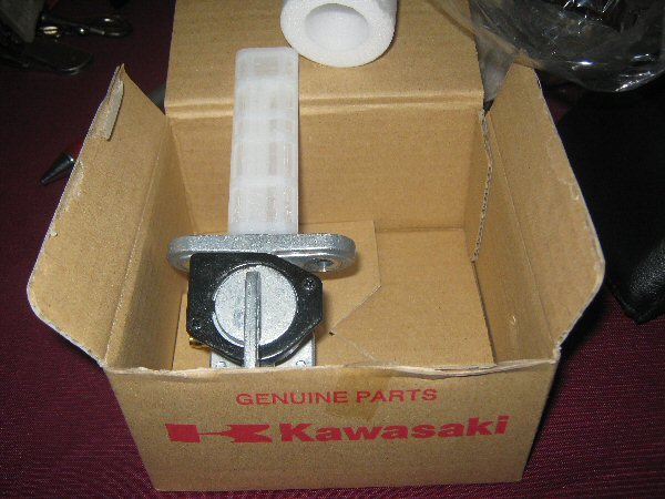

Just picked this up, new old stock, now just have to make a vacuum connection for the bolt in number 1 inlet

At present i'll just be using it as a "normal" fuel tap, till I get around to doing the vacuum line, run her in the prime position , park it in the on or res position. Was thinking of going to a hobby shop to look at fuel line connections for gas powered model planes, there should be some small nipples I can use there, or make my own
