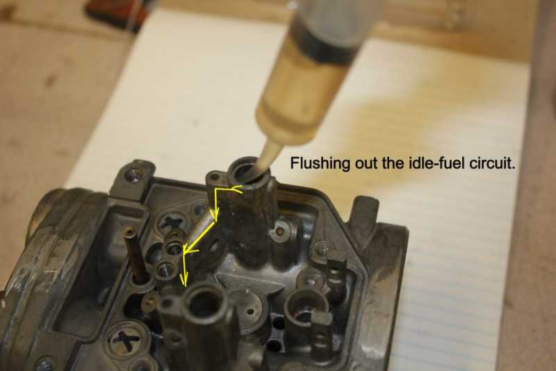

I know there are heaps of posts about this but can't find a solution to my particular problem. Following Scotch's excellent thread on carb rebuild and amazing photos, I have been trying to clear one of the idle circuits. I have a syringe and lots of laquer thinner, getting good flow on one high speed jet tower down to the exit in the idle screw cavity but for the other tower on the same carb I can't get any flow at all, can't even get air through. Emmulsion tubes and idle screws removed. Any suggestions on how to get this sucker cleared?

The smallest point in the idle circuit where the circuit gets clogged up is at the 3 tiny transition ports you can see in the carb throat bore. One of the ports is visible when the throttle butterfly is closed on the engine side of the carb and the other two can be seen when the butterfly is open. Those ports are around .020" (.5mm). It's imperative that when trying to clear the idle circuit, you have to remove the idle jets (pilot jets) the pilot air screws, the main jets, and the enricher valve. Scotch's cleaning tool is the best for clearing these ports but I have had success clearing this circuit with an air blow gun and 100 lbs of air. The main thought here is that the circuit needs to be cleared by reverse flow of solvent or air from the transistion ports backwards through the passage and that's why all the removable parts in the circuit need to be out so that the obstruction can be free to blow clear.
I modified a blow gun by removing the tip (nozzle) and fitting a piece of 1/4" copper tube with a 90 deg bend in the tube so that I could point the end of the tube straight up at the transistion ports.
Lacquer thinner in Canada is not the same as "thinners" as they refer to it in Europe. Thinners is paint thinner and is a variant of varsol and won't do what lacquer thinner does. Thinners smells like a mild form of diesel fuel. Hopefully you're using lacquer thinner.
If it's that clogged it will take some time. The lacquer thinner needs to be able to get at the varnish that has formed from the stale gas and a really clogged circuit won't be an easy clear. Have some patience and let the carb soak. Keep trying to blow it clear from the transistion ports side and as the blockage starts to move, the lacquer thinner will be able to get at and work on the varnish.
Above all , don't try using anything like a piece of wire forcing it in the transistion port. You'll bugger up the port and possibly break off a piece of that wire in the port . (or maybe that's the problem a previous owner did and passed the problem on to you)
Let us know how you made out please.

What kawboy said with an additional warning regarding any attempt to clear the idle and transition ports with "a wire" or God forbid one of those "Jet Cleaning" tools; otherwise know as Oxy/Actyl "tip cleaners"

I am actually getting flow out of the transition ports so pleased about that. It is the idle fuel circuit on one tower I am having trouble with - will try to attach photo from Scotch's post - one side clear and flowing into idle screw cavity, other tower not showing any sign of air or thinners flow. I found a laquer thinner which is as close to the Solvable specs as I could find and has the following;

I have heard of folk carefully drilling out the small brass balls opposite the elbow bends so you can get a straight run at the channels - has anybody done this successfully and know the diameter of replacement balls to bung 'em up again afterwards.
