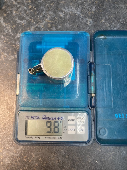

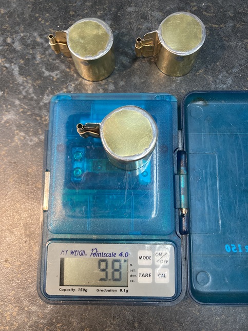

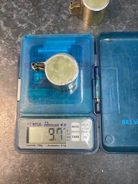

Yesterday I wrote:
Initially, I was weighing the floats. More out of curiosity. As my soldering skills and techniques became more refined I found there was no need for this procedure.
I can assemble floats within +/_ 1 gram.
I realized this morning that a missed "the Decimal point" ! Should have read +/_ . 1 gram.
These floats are the most recent set fabricated. Some skill and technique for the soldering aspect is certainly important but equally true is the consistency/accuracy in cutting all the pieces. Jigs and templates deal with this.
And for the conspiracy theorists and skeptics: 3 individual floats - not one, cleverly re-photographed !
