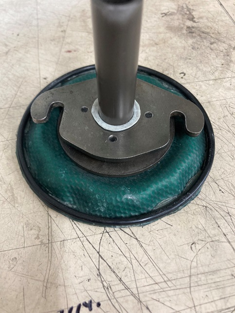

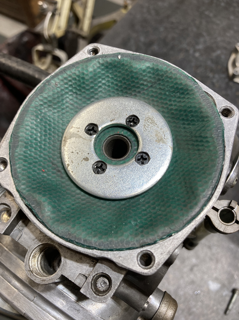

The OEM diaphragms have a reinforcing membrane bonded between (Butyl?). This provides a thin, flexible and non-stretch diaphragm.When I first became aware of the after-market diaphragms, they appeared to be merely a single layer of Butyl (?) and my first thought; remembering back to the 1980 “road trip” was: How would they preform when cold.With the current controversy regarding some of the after-market diaphragms being too stiff it seems logical to believe they could become inoperable when the carbs get ice cold when highway riding.To my knowledge no one has commented to this regard specifically but “carvers” latest video demonstrating an after-market diaphragm being so stiff (at room temperature) brings into question the actual suitability of this product, as it differs significantly from the OEM’s.

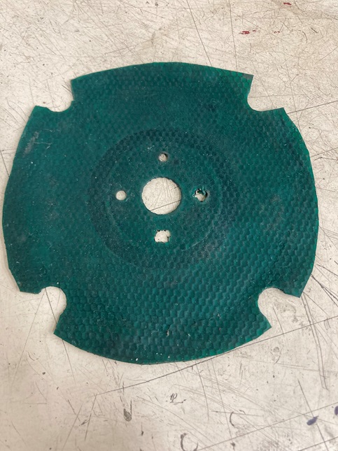

Several years ago, I thought I’d explore the possibility of making diaphragms, similar in construction as the OEM’s. That project got side-lined until several days ago when I thought I’d resurrect the idea. Some technical issues in making these have yet to be dealt with but I will continue and see what comes of this idea.
For the life of me I can't get a couple of videos posted here, showing the action of my diaphragms so you'll just have to accept me at my word that they perform as well as the OEM's.

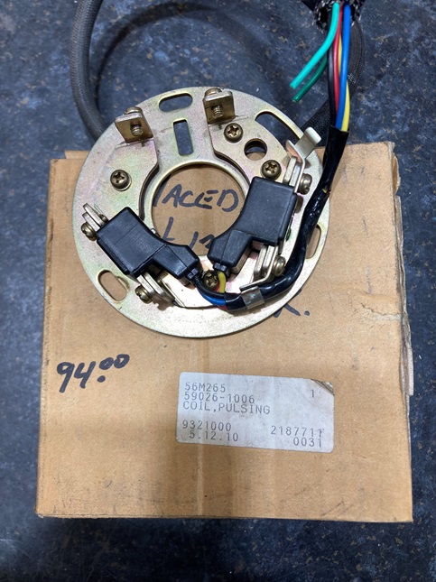

Just for "shits-n-giggles" because they were mentioned here: note the price....back in the day. Kawasaki supplied them as a complete assembly
