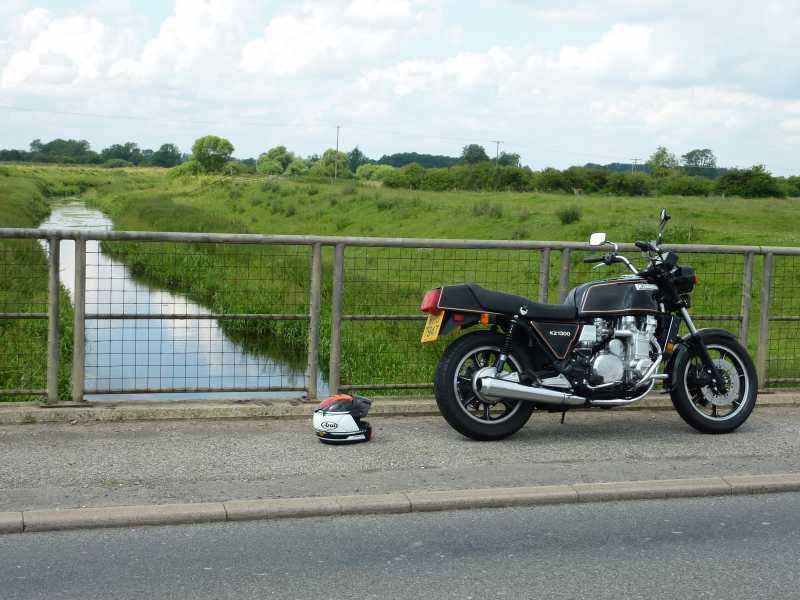

Here she is in all her glory on a glorious English summers day - sadly we dont see too many of them each year - really enjoying riding the old girl.
Cheers Tim
