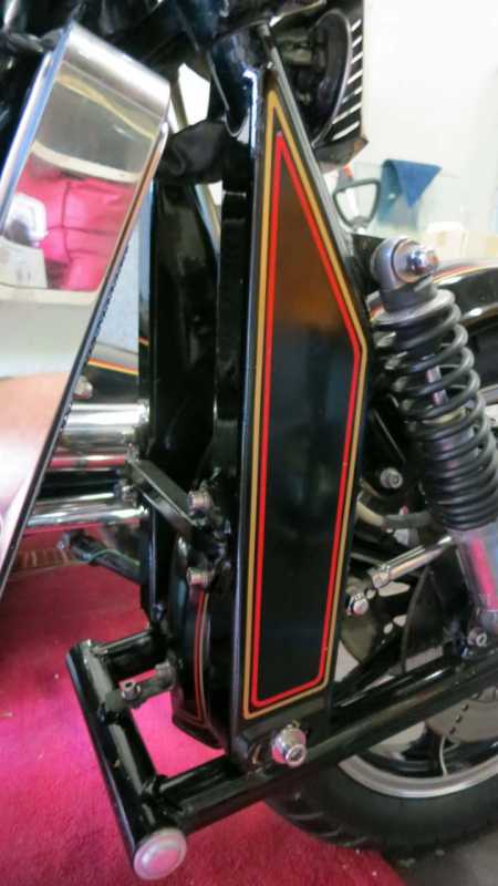

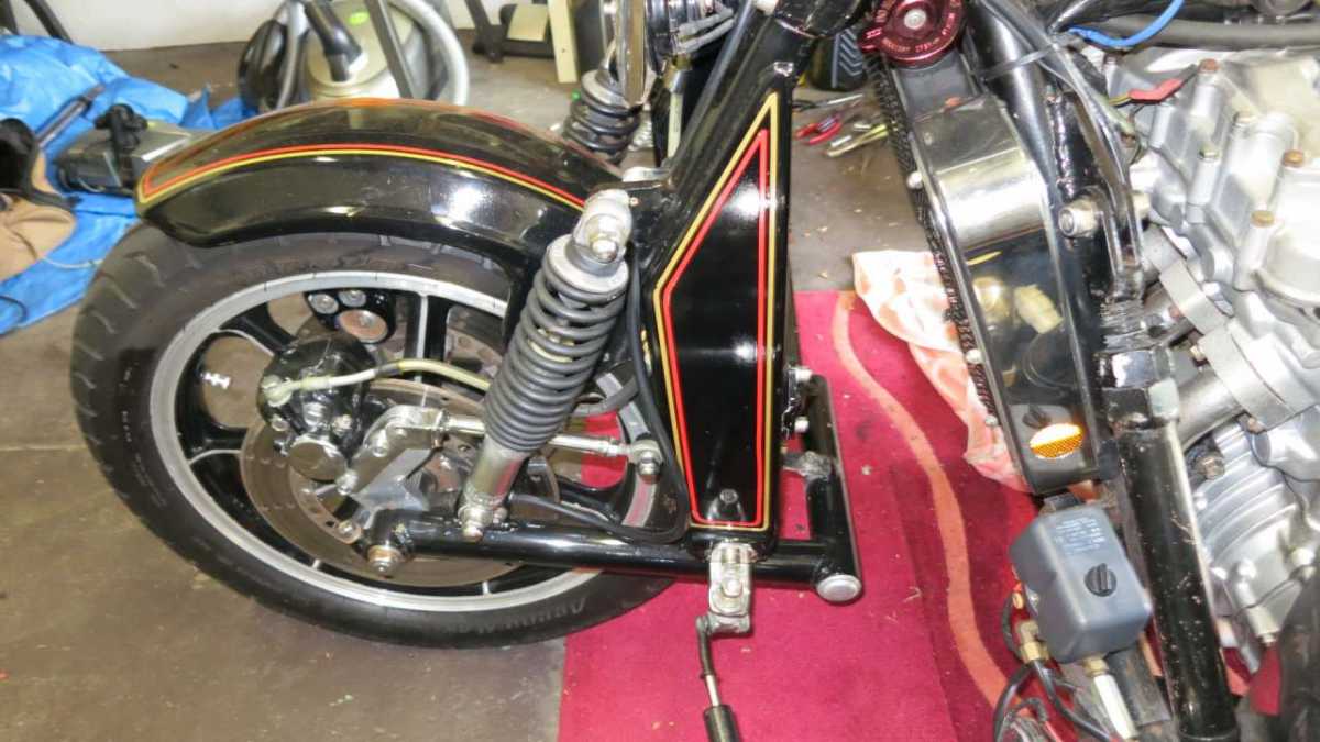

The leading link front end is modelled on the Bob Martin engineering unit but with improvements. Front brakes are fully floating. This eliminates the rise of the front under braking as with Bob Martin's unit.

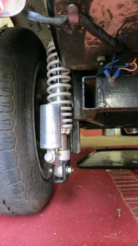

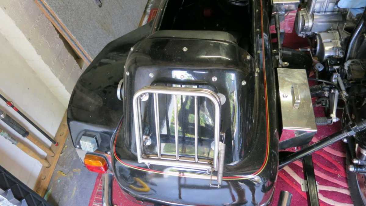

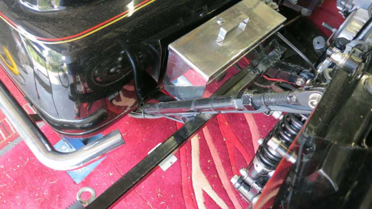

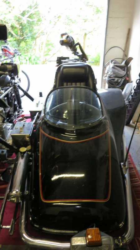

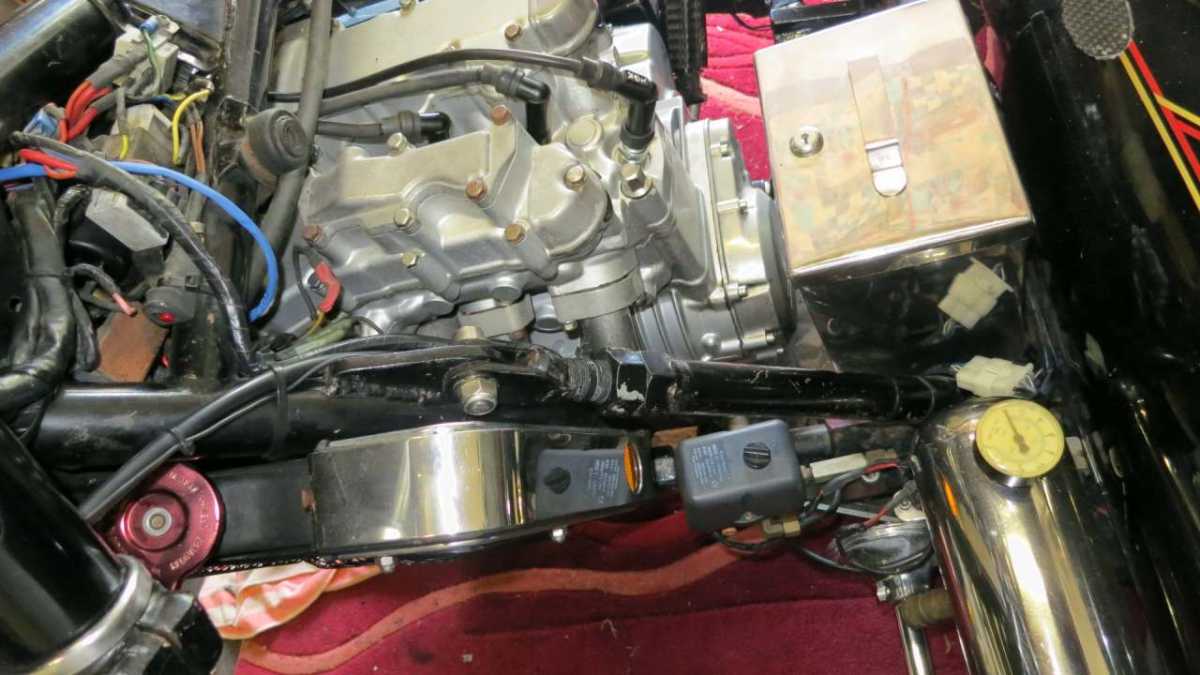

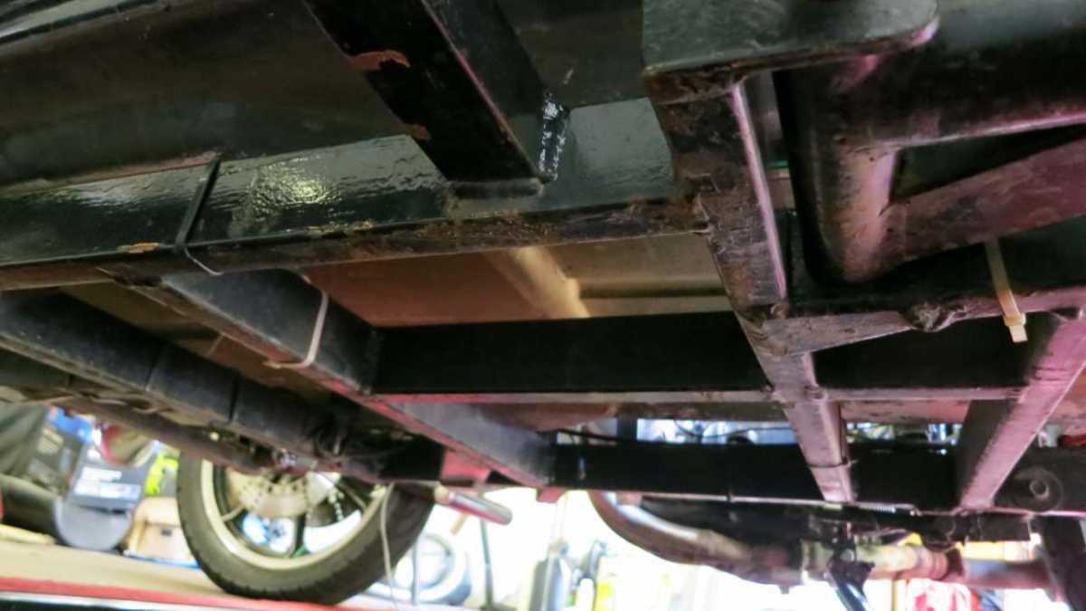

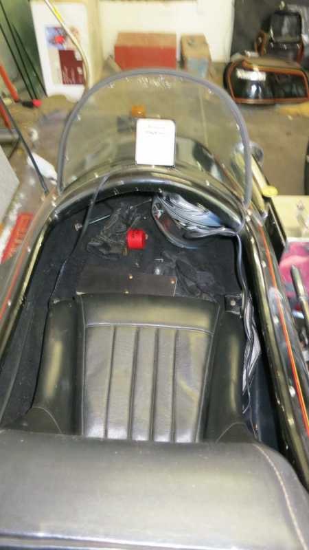

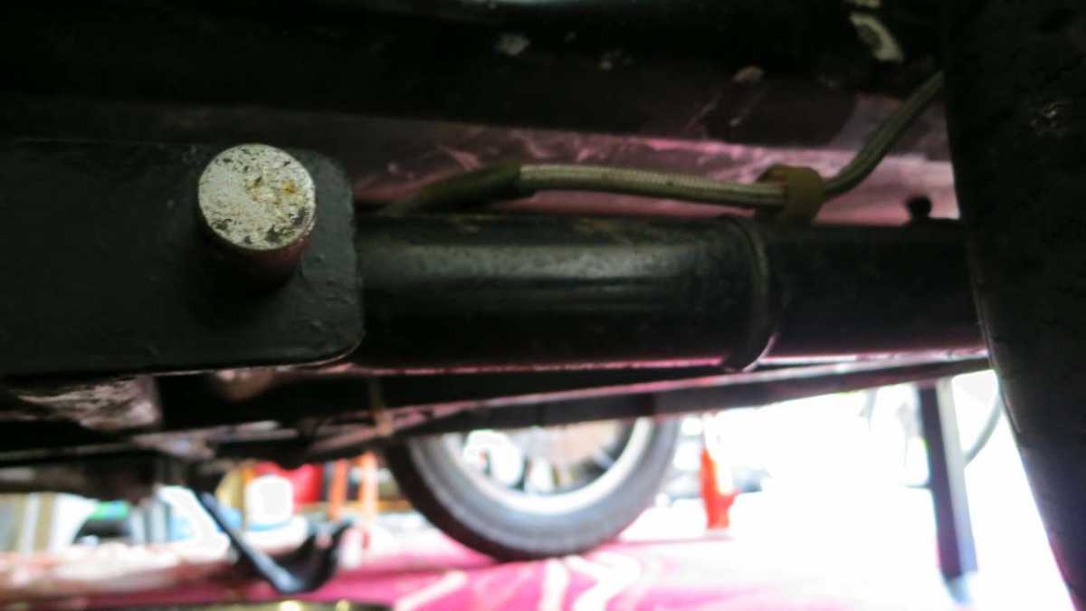

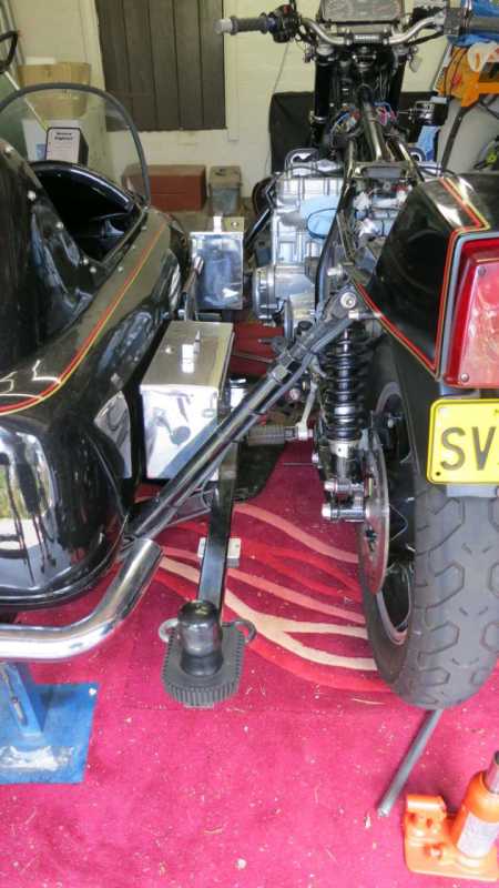

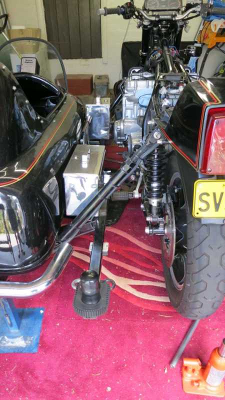

Well I finally have had time to throw the pics up for you of the sidecar and leading link

That sidecar body is from the same manufacturer but has the wheel arch moulded into the body where mine has a totally separate moulding over the wheel and the frame is very different.
Now of course the big question is do you know who is the manufacturer and who made the leading link.
