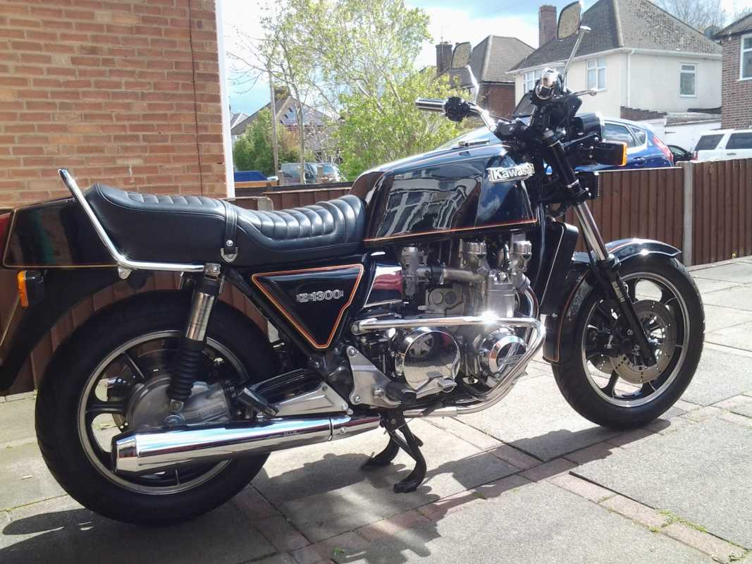

9 years 11 months agoMark wrote: Dave, that frame looks like it has been painted recently I might be wrong but it look great in your photo's. Have you checked all your earthing points, along with all electrical componants such as coils ignitors etc that they are earthed to there mounting points i.e you havn't got new frame with paint preventing good earths.
Remember your frame is the electrical return to your battery etc.
Paint work on frame is original and only been polished up. All earths been triple checked, all connectors stripped cleaned. Had a scope on the pick up coils to check and all voltage readings as per manual check out. Remember its an A3 model. The swine of the bunch for electrical problems :evil:
