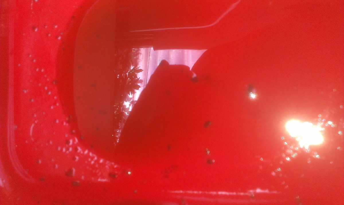

Another problem which I don't like the look of (I said it had gone too well) I dropped the oil into a bowl and when emptied out there were some small shreds of black plastic and a few tiny fragments of metal. This i presume must be bits of camchain tensioning parts, I've only ridden a couple of miles. I fitted a new nylon cog and holding rubbers in the block by lifting the tensioning gear up and dropping it back with the new one in, then fitted the ZZR tensioner with cut down spring and heard it ratchet in.All the runners and chain seemed fine before, unworn apart from the cog. I dont know if I could have dislodged something or the ZZR unit has overtightened somehow, it did seem a little noisey on tickover which I thought could have been clutch or primary chain, hopefully my next move isn't to pull the whole thing apart again..HELP!

Shot in the dark hear Charlie not rubber related, but these can be prone to bolts coming loose in the starter motor clutch, is the noise coming from that area, if so they could be rubbing on the casings, just a thought when you mentioned noise, though you did say you were on tick over and not trying to start. This could also be remnants from the past

Hmm , food for thought, I'll maybe run it carefully a bit more and monitor the oil, if it does anything nasty I'll be shutting off and back to the spanners.

those bits could have dropped in when you removed the head and cleaned the faces.
that sump is big and can hold a lot of debris from the past that maybe washed out when you drained it
put your new oil in it fire it up and go round the engine with a screwdriver cupped in your hand, stick the point on the angine and listen to
whats happening inside.
if no nasty noises give it a run and drop the oil again just to be sure, it wont hurt to put the same oil back in.
