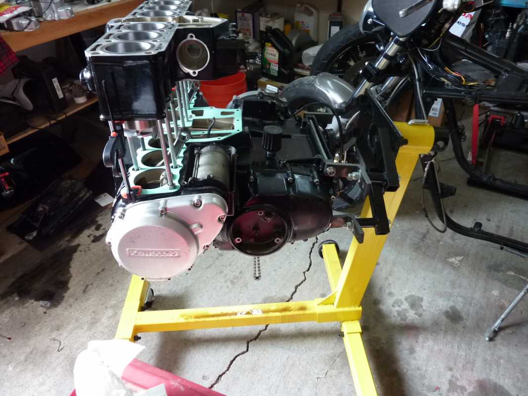

Found some more, this time of the top-end rebuild that I did about 6 years ago:

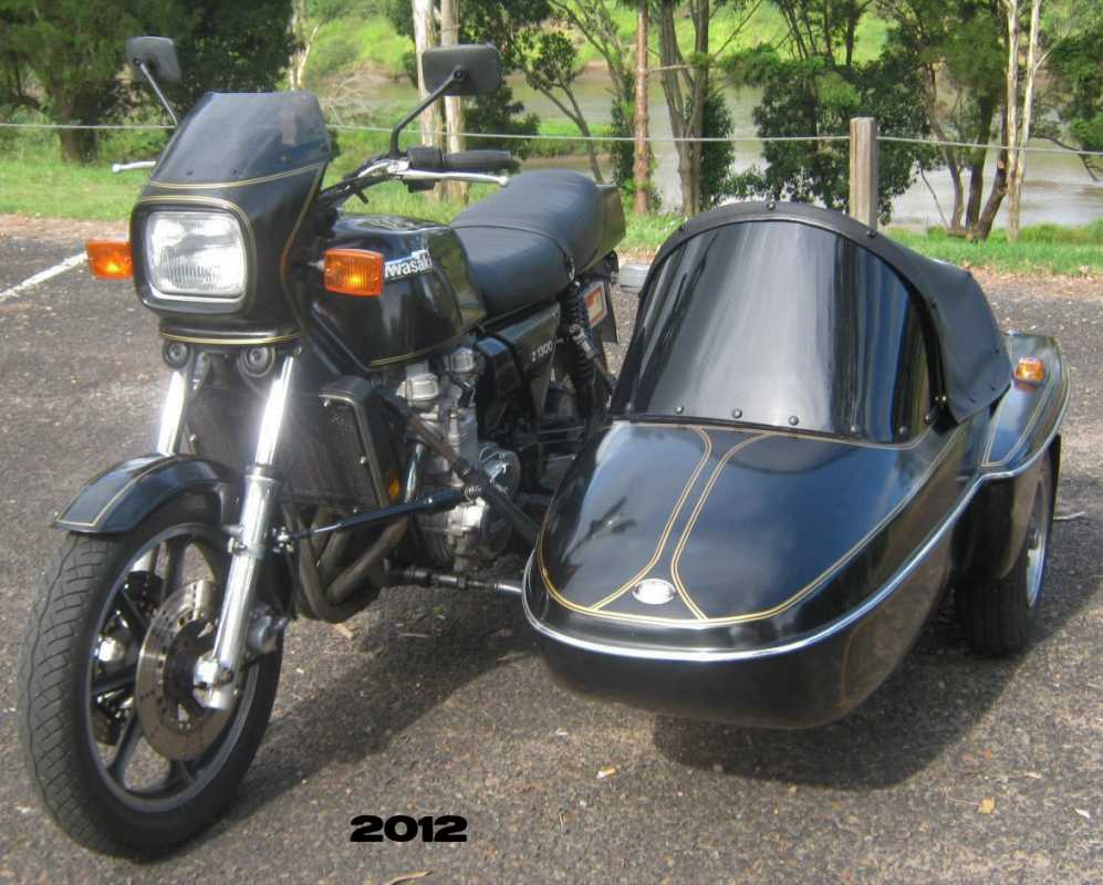

Mine now

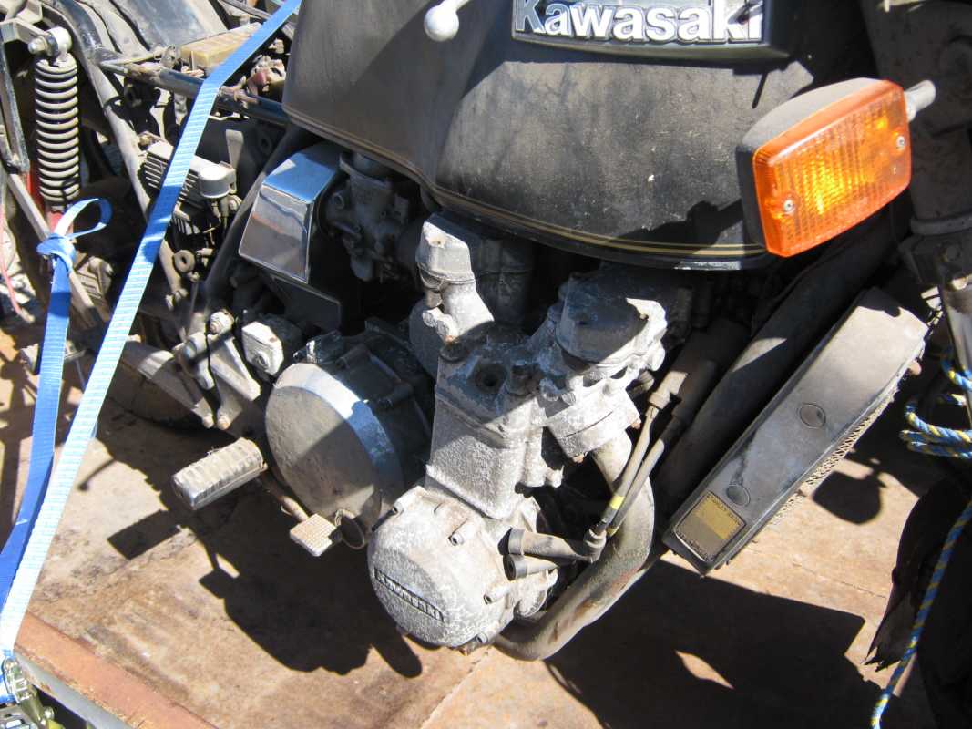

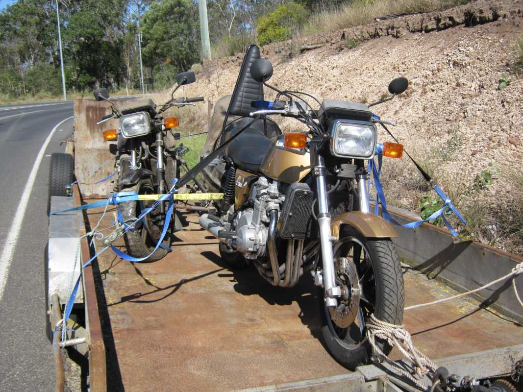

When I got mine now and a "spares" bike
Bit of corrosion, it was inside a shipping container for a few years
Chair that I put onto mine
Spares bike

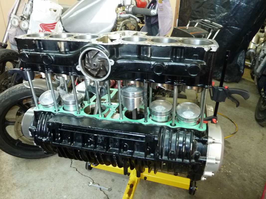

When you have to be able to do the rebore & fitting of new pistons by yourself, this may help.
The little plastic clamps had just enough friction to hold the block exactly where I wanted it, and as each set of rings where worked into the block, I gently tapped the block down with a rubber hammer.

Good idea. Thanks.
