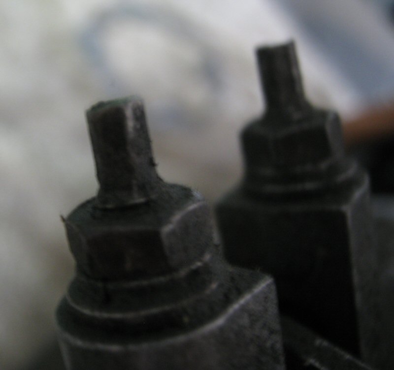

Ok I've had a bit of a shock ... usual thing, cost of stuff, I adjust the balance of the carbs using a bit of a homemade spanner for the shaft, thought while on holidays i'll order a "proper" spanner at least that way i'll always have it, got the tape out and measured the old ones on the set of carbs I took off and came to the conclusion that i'd need a 3.5mm spanner, please tell me i'm right and it's not a 3mm or a 4mm ???, anyway got online and holy smoke, you'd think i'm buying a cheap complete socket set from china ... Stahlwille Combination Spanner 3.5mm = $18.43 AUD, anyway c'est la vie, I needed one anyway
