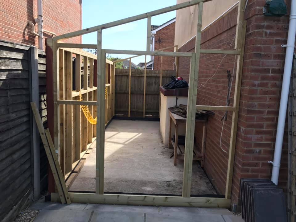

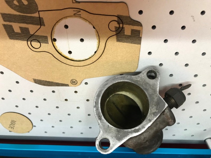

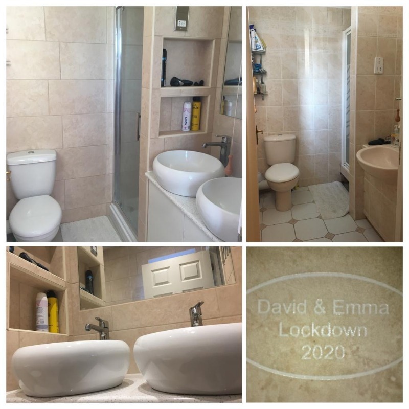

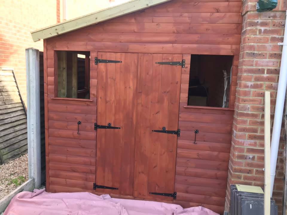

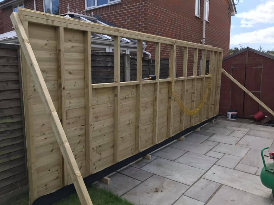

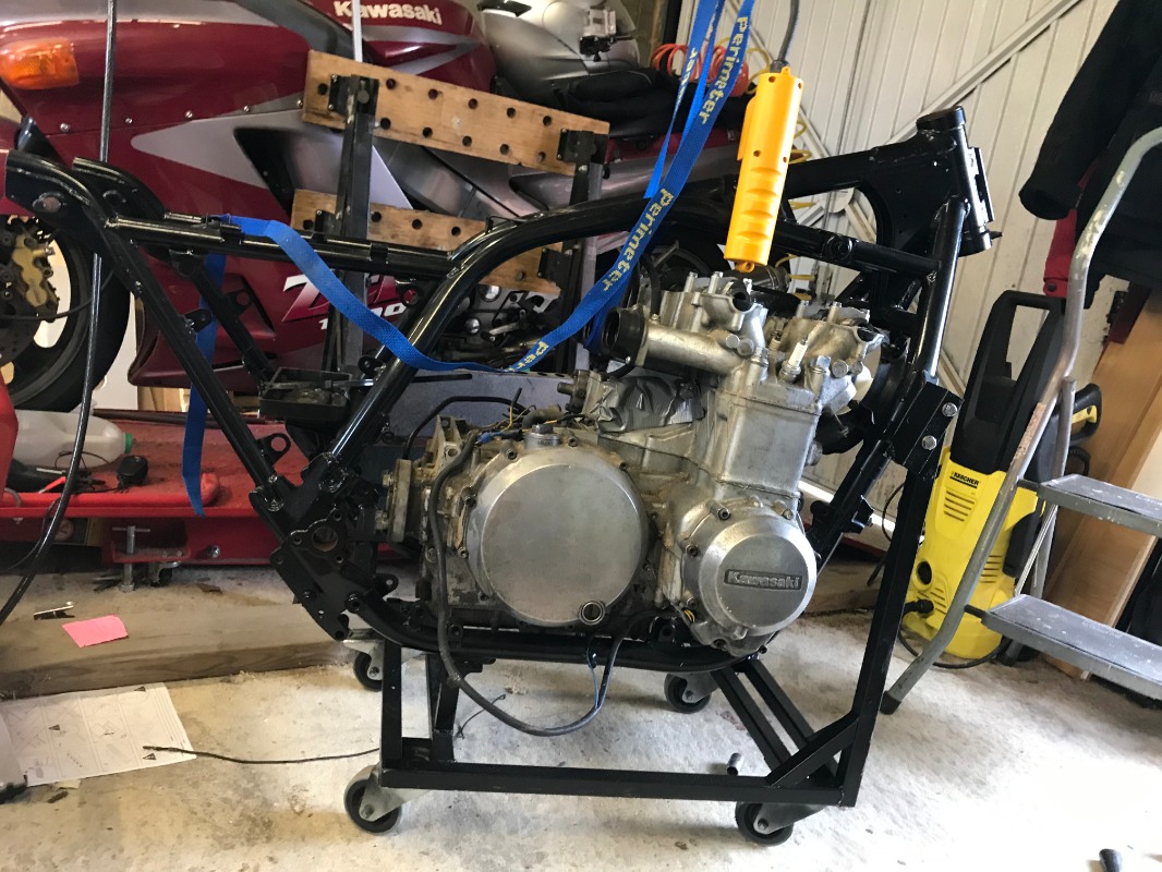

Wife has had me doing a lot of DIY since march, en-suite, new shed build from scratch, hot tub - but I did get some time to work on a rolling stand for my spare engine in the hopes of getting it running . Also cut a couple of gaskets on laser cutter - so far transmission cover and top hose housing
