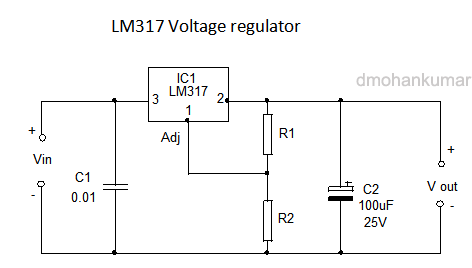

Yup ! It was me. Seems everything else has been covered so per "the Bible", check the voltage output of the instrument voltage regulator.
It's a simple circuit. This is a similar schematic:
If it checks-out, test the temp. gauge sender.

5 years 5 months ago - 5 years 5 months agoscotch wrote: I'm hoping that I'm not having a senior's moment but I also have it in the back of my mind that Scotch came across this some time ago.
As I understand it, the job of that voltage regulator is to supply a constant & stable 7 volts DC, irrespective of battery voltage, to the fuel & temperature gauges, so that the needles don't move with the constantly changing battery voltage?

5 years 5 months agoPhil wrote:scotch wrote: I'm hoping that I'm not having a senior's moment but I also have it in the back of my mind that Scotch came across this some time ago.
I assume the regulator is in the instrument cluster? Off to the FSM and Thank You!
