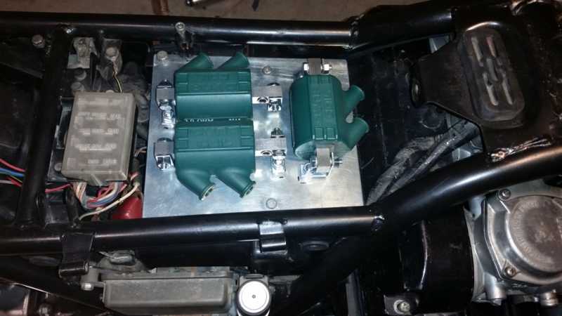

I'm in the process of mocking up a plate to mount my ignition coils where the tool tray would be fitted above the air box. Planning on using Dyna coils, the 3 ohm green ones. Before I get too far along I curious if anyone had done this before. I think a member here had a picture of 2 coils under the seat??? Is there room for 3?

That's the one, thanks. It looks like I can get a 3rd on in front of the two you show mounted in the tool tray. Or would they only fit in the back portion of the tray? Is there enough clearance to he seat put a third one in front? I don't have the tray. I was going to make a plate.
There some cases in the automotive world where the coil pack is not tolerant of bad spark plug connections or poorly matched wires. But it's the coil pack that cant take it, these are usually integrated ignition module/coil pack jobs... a General Motors Quad 4 comes to mind. In these bikes the IC module doesn't care beyond the resistance of the ignition coil so it shouldn't matter. Id like to put them under the seat to keep them cool, and to make service easier.

The aw82's look good, but I had a Dyna coil laying around already and picked up two more. They're not too much more expensive, they run less than $60 each new. Plus I already run a set on my other bike (kz650), so now both motorcycles will run the same ignition coils.
The 3 Ohm Dyna coils actually measure 2.6 Ohm, I checked my stock coils and the ballast resistor in series and they measure 2.7 Ohms.
Here is what I came up with to mount them.
