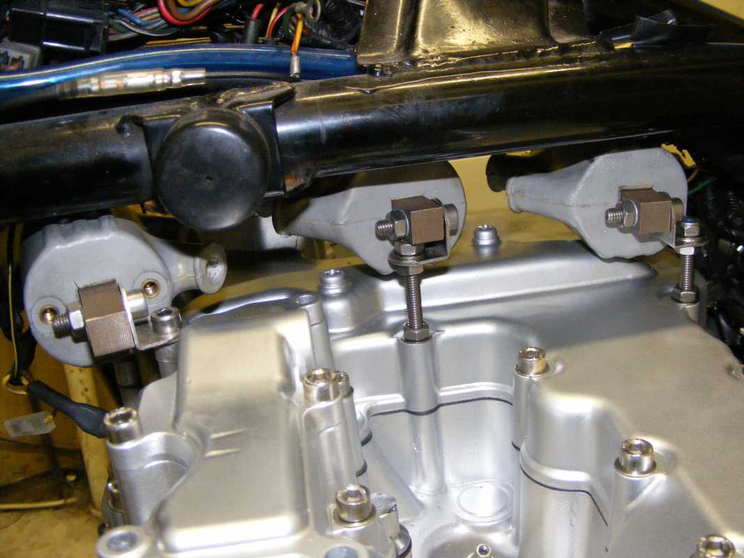

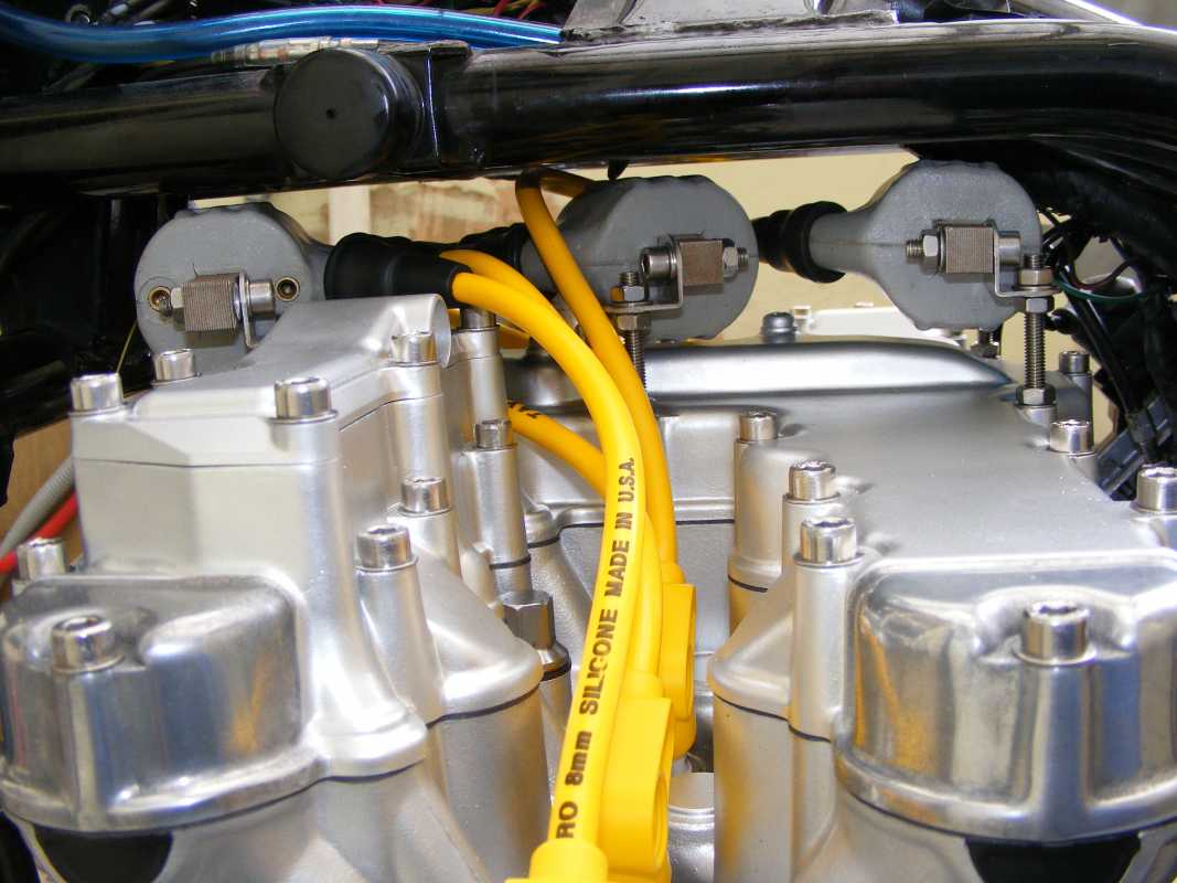

Not so much a guide Pete, more like pics showing the Dynas located on the cam cover on my 13:
It has to be said that it does make it more of a faff everytime I want to remove the cam cover though of course.
And I concur that the Dynas will fit in the original position, but it is VERY tight.
