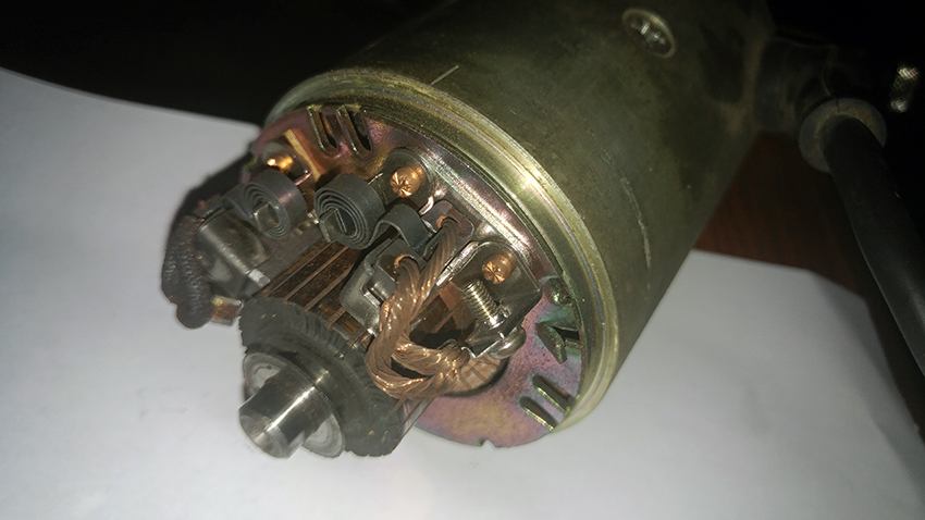

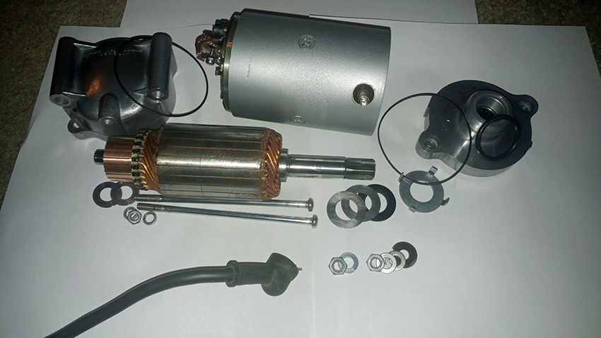

In case of KZ1300 there is insulation there.
I'm re-posting a couple of photos for reference.

Took starter apart and tested the commutator. minimal readings between the segments, but I get a reading between the commutator and shaft. According to the manual that means there is a short and I need a new starter or to get this one rewound. Guess its time to go shopping. Brushes are well within spec, btw.
