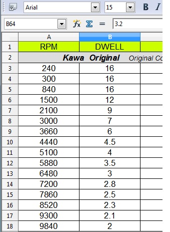

Hi just two cent from me, sometimes back i rebuild the ignition too, in order to tackle off idle problem and while searching for ignition modules i measured the dwell times of the original Kawasaki igniter with oscilloscope. Here the data picture. Maybe someone find it useful.
Dwell time in milliseconds.
