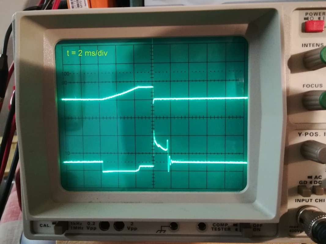

Ok Kawboy osci beam passes from left to right that's time and i will set it to different values per each square, you can always see this in top left corner on the picture. Also voltage varies, this time beam travels up and down and shows how much it changed in given time. One thing though i hope its not getting boring, probably half of the readers have fallen asleep till now, so if it is we can cut to the chase and get to the practical part straight, because there is still some stuff to talk about so let me know.

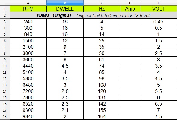

Standard kawi igniter makes 0,8 millisecond spark when using standard spark plug and have managed to push the spark through at ten bar only under 1500 rpm above that, energy from coil have gone over ceramic or debris on it in to the ground. Already at this stage there was no spark in the chamber at all but the plug outside had spark. Between 1500 and 7500 rpm dwell time reduced from 10 to 2 milliseconds. I remember long ago I had made similar test and the figures varied slightly from that, on different igniter, maybe the setup was little different or due to lower supply voltage. After installing iridium spark plugs things got slightly better.

what is column E "volts" ?
It is my understanding that the Darlington transistors add dwell (energized time of the primary) as the rpm increases which is contrary to your findings. Wonder why?

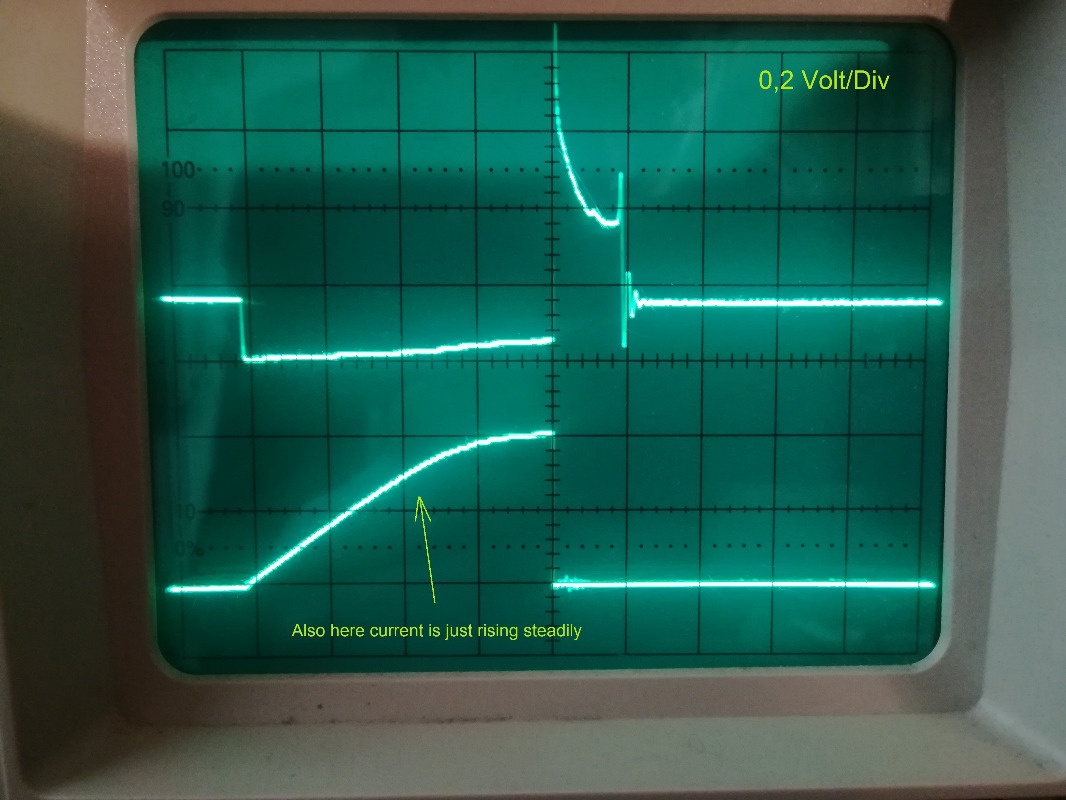

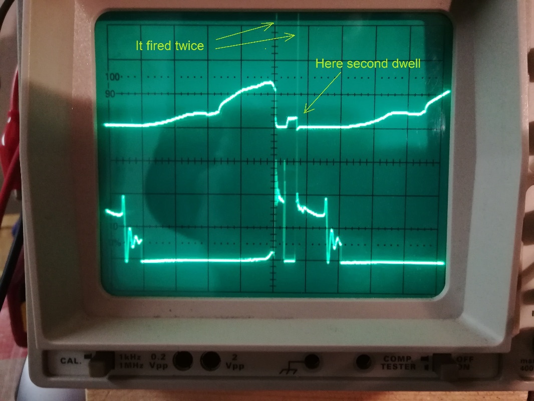

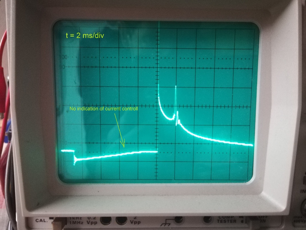

Kawboy column E Volts is for my own reference only. When testing it indicates the rpm simply by reading the voltage applied to the motor, bench psu have digital multi meter so its easy. First module i have tested and actually it was running in the bike was the Hella 5DA 006 623-051. I didn't know what to take so i when for it because of the manufacture name i know for many many years. Initial testing did not reveal the great weakness of this unit. So first it was a success because i have manage to build my own ignition and fitted to the bike, however the happiness didn't last for very long, after discovering that the bike have slight stumble up on quick throttle, or in stand still reeving up. This is how the "research" was born
. So after getting over the disappointment i started to look at the problem ahead of me in more theoretical way, because it was clear with out it there will be no new ignition i so desperately want it to have. After looking at the trace i suspect, there is no current control on this unit because current draw is gradually rising with no indication of something taking any action visible on the trace. The unit charges the coil with: I=U/R, I=0.4V/0.05 Ohm = 8 Amp. After i added 1 ohm resistor in series with the coil current dropped to 5 Amp at the engine speed around 500 rpm maybe. Second thing is that up on sudden acceleration it skips one pulse as the result engine develops noticeable stumble, like when the idle to mid range lucks fuel. And so it was Game Over for Hella for me, because i have expected more from such old manufacture, oh well.

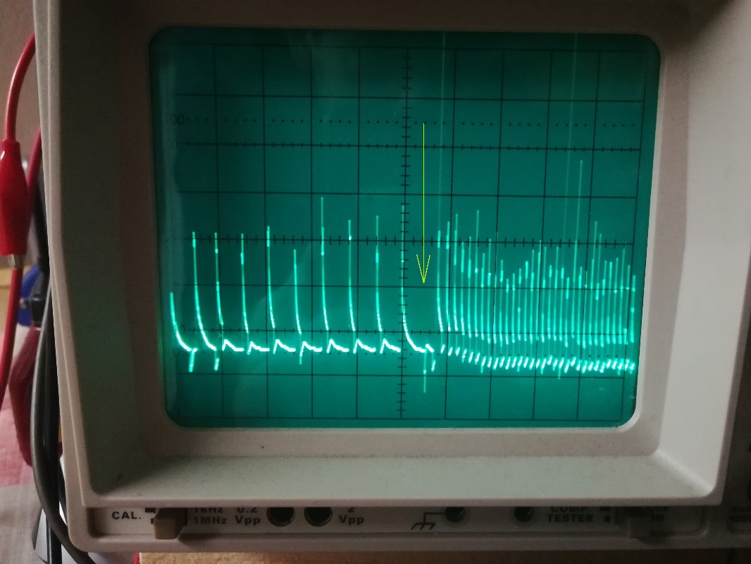

Next unit tested was 03SKV906 equipped with MC3334 chip. With this device i manage to reach 5000 rpm only and modification of the internals was actually out of the question, like i wrote before i want it to have something ready otherwise i would make one my self. I suspected that the pickup coil is not compatible with it and as result it starts to switch to dwell at high rpm's.
