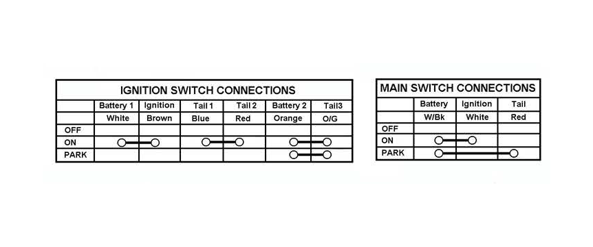

A brief introduction to electric diagrams.
Switchs- On an electric diagram the switch pin connection shown is usually shown in normal operating position.
Usually, multi position switches have a notation somewhere on the electric diagram identifying the standard connections in each of the switch positions.
On the bottom of the electrical diagram for each of the KZ1300 wiring diagrams are the notations for the switch positions. I've copied the switch positions for the ignition switch and the main switch here for discussion.

I've found the issue...
I re bridged the white wire from the multi connector before the ignition switch, which read 12.6 volts, directly to the Brown wire and noticed the voltage immediately dropped to 1.2 volts. Sneaky!
So I figured the white must have an issue. and followed it back to the main switch at the side panel. I removed the switch completely and bypassed it by plugging the 2 wires directly, and bingo, I have power again. So I guess it's a rebuild of the main switch as well.
That was a tricky one to diagnose! Thanks again!
