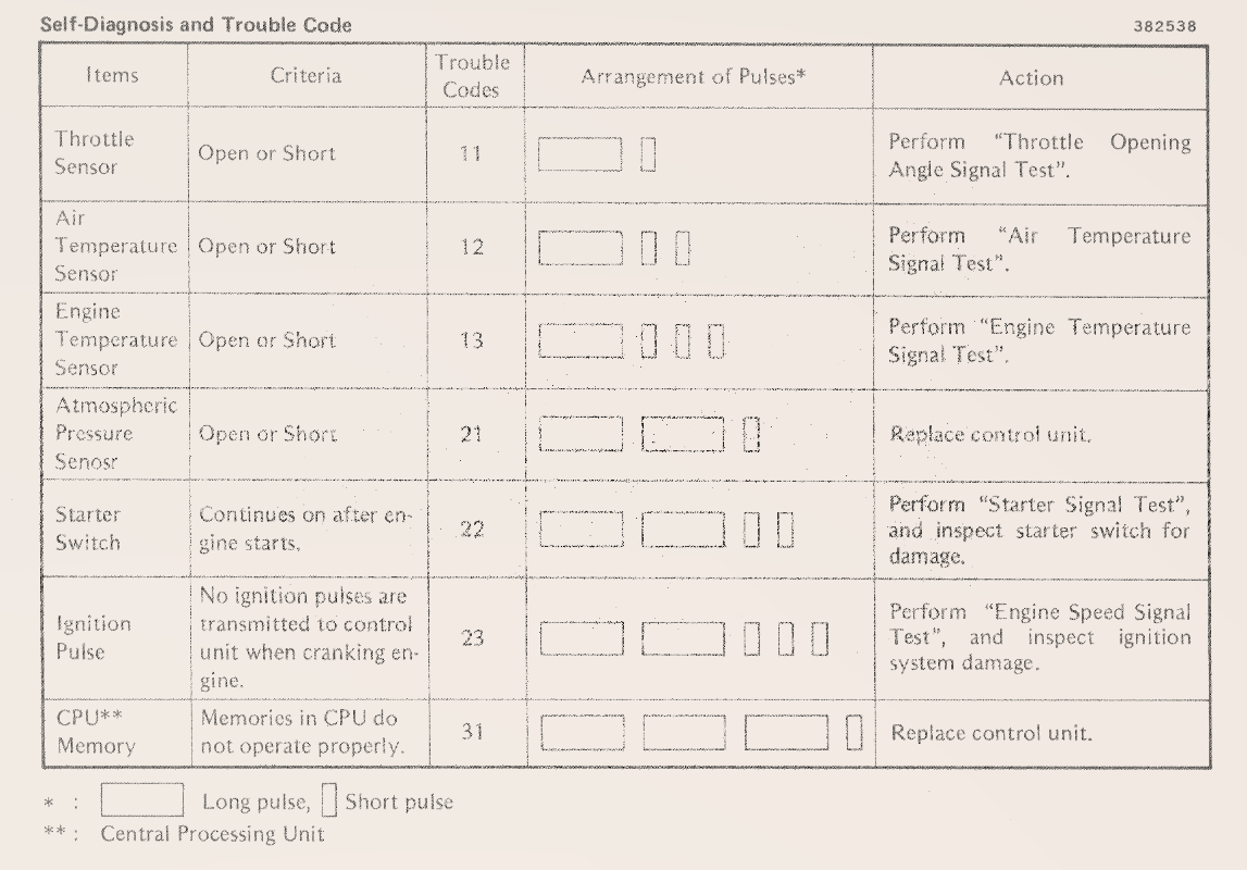

still got the flashing dfi light, one long blink and two short                   back to the zn manual
  • Kawboy
  • Kawboy's Avatar
  • Posts: 3243
  • Thanks: 1198
Re: DFI kill switch is turning my oil light on ?
2 years 3 months ago - 2 years 3 months ago
#32332
Air Temperature Sensor fault. Likely a bad connection.

Ok now i have three error codes : engine and air temp ,throttle position
Also have power to the coils but no spark when cranking bike.
Plot  thickens, is there a test for the ignitor, does have some burn damage back there.

Correct, the coil was energised continuously which why I fried it.
Went looking for a crossed wire and found an entire crossed plug, need new glasses!
Reversed the plugs and it started on four.
Have still got one dfi error , air sensor , however have a new one and they are directional so may explain it.
